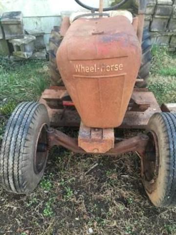

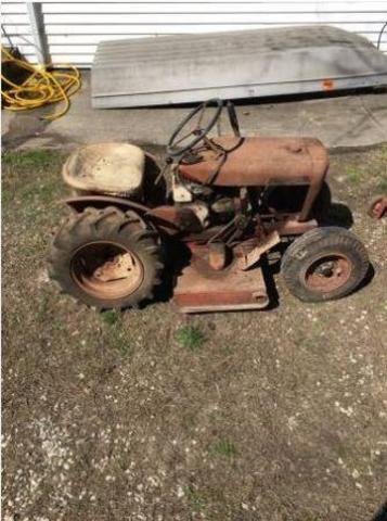

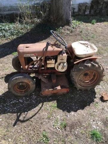

Bow_Extreme 580 #1 Posted March 28, 2016 (edited) This is for sale locally and I am thinking about picking it up but I'm a little inept to the specifics on these older models. I know the motor is not original, the hood appears to be cut in the back, the original muffler appears to be missing and heat shield, but I may be wrong on some of those items. And approximate value would be appreciated. I know it needs restored. All help is appreciated!! Thanks Edited March 28, 2016 by Bow_Extreme 4 Share this post Link to post Share on other sites
Achto 29,983 #2 Posted March 28, 2016 Judging by the hood and the foot pads, I would say it is a 1960 400 or 500 suburban. The difference between the two being engine size. 1 Share this post Link to post Share on other sites

Achto 29,983 #4 Posted March 28, 2016 (edited) Mower deck also looks correct for 1960, 61's had wheels on the deck. Hope the front rims aren't rotted out, a lot of them are because they were filled with fluid from the factory. The rest of the sheet metal will take some welding but looks repairable to me. As for a price, I've seen them from $500 to $1000+ restored. These were asking prices. Edited March 28, 2016 by achto Share this post Link to post Share on other sites
ol550 836 #5 Posted March 28, 2016 From what I can see from the pictures a 400. Whoul take a good look at the front wheels as to how deep the rust goes. The hood cutout was made for function with the transplanted engine. The front of the hood is shifted over, possibly due to rust or just a missing bolt. It is also missing the belt guard for the deck drive belt. As for price... whatever keeps everybody happy, I've given as much as 350 for less than what is there though. Share this post Link to post Share on other sites

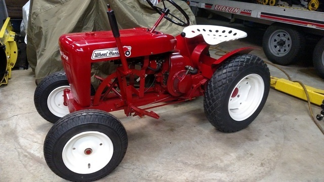

Achto 29,983 #7 Posted March 28, 2016 I paid $50 for this one. Stuck $ 150 in the transmission alone. 5 Share this post Link to post Share on other sites

RedRanger 1,470 #10 Posted March 28, 2016 Does it run and drive? The little things will nickel and dime you. Based on condition=wrong engine, rusty front rims (look rotted in pictures), cut hood, rusty controls=I'd assume the mechanicals are just as bad. I wouldn't give more than $200 as is. Looks like a $100 tractor to me. It's a 1960 400, not an RJ. It's not exactly rare. Don't get in over your head. Nicer burbs are out there for reasonable amounts. I gave $600 for a restored 401 with correct engine, solid gas tank, nice tires, solid rims, good steering wheel, and good sheet metal. 4 Share this post Link to post Share on other sites
Achto 29,983 #11 Posted March 28, 2016 One other thing to mention. The hole to the right of the steering column was on all the 500's. It was for a kill switch for the Clinton engine. Some 400's will also have this hole (mine does not), but they would simply put a plug in it. 2 Share this post Link to post Share on other sites
953 nut 62,498 #12 Posted March 28, 2016 Given the cosmetic issues and wrong engine if it runs and the transmission works without any issues I would say grab it for $200 or less. Non running I wouldn't go over $100 because the transmission could have problems you won't know about until it is too late. 1 Share this post Link to post Share on other sites
