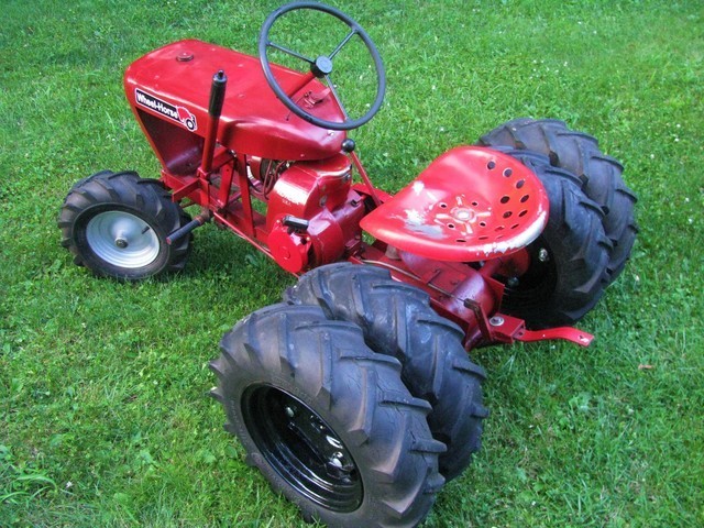

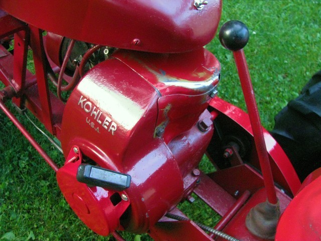

AMC RULES 37,250 #7 Posted March 28, 2016 Techy recoil on this ol' girl too. Share this post Link to post Share on other sites
