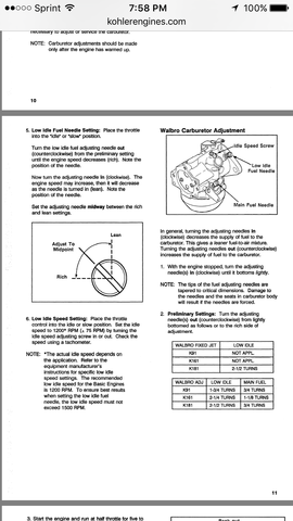

leeave96 490 #1 Posted March 25, 2016 I've got an 8 hp Kohler K-181 engine and a manual for it. I just did a carb clean, new gaskets, etc., and now am trying to reset the carb. My manual shows a Walboro carb, but what I have on this engine looks like a Kohler/Carter model N. High speed main jet is on top of the carb. The only marking on the carb is 4147804. That is cast on the left hand side, no markings in the intake throat like other Kohler/Carter carbs I've seen in the past. Anyone have the initial carb settings for this carb? Thanks! Bill 1 Share this post Link to post Share on other sites
rmaynard 16,562 #2 Posted March 25, 2016 Low idle 1-1/4 turns from bottom, main jet 2 turns from bottom. 3 Share this post Link to post Share on other sites
DadsToyMomsHeadache 3 #3 Posted March 25, 2016 http://www.kohlerengines.com/onlinecatalog/pdf/ens_593_f_all.pdf 1 Share this post Link to post Share on other sites
