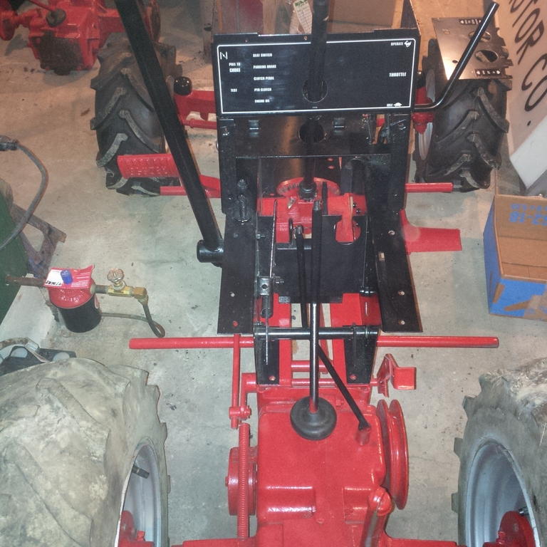

MalMac 1,336 #27 Posted May 22, 2016 Looks like you are putting forward swept axel and reduction steering on. If that's the case, drill your extra set of holes for your steering reduction before you put the hood stand on. Also you will need to grind a little off the upper lifting arm because it will interfere with the bevel gear. Mine I had to grind down just about to the first hole. I have done a few add reductions and each one needed ground a little differently. Looks like you pick up a wonderful machine. 1 Share this post Link to post Share on other sites

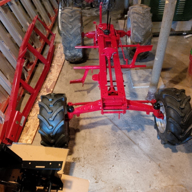

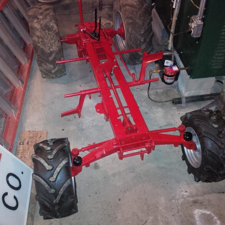

fast88pu 3,393 #28 Posted March 22, 2017 Been working on it again. Will be finished by end of summer. Progress may be slow with my 3 week old daughter. And mainly all NOS sheet metal 14 3 1 Share this post Link to post Share on other sites

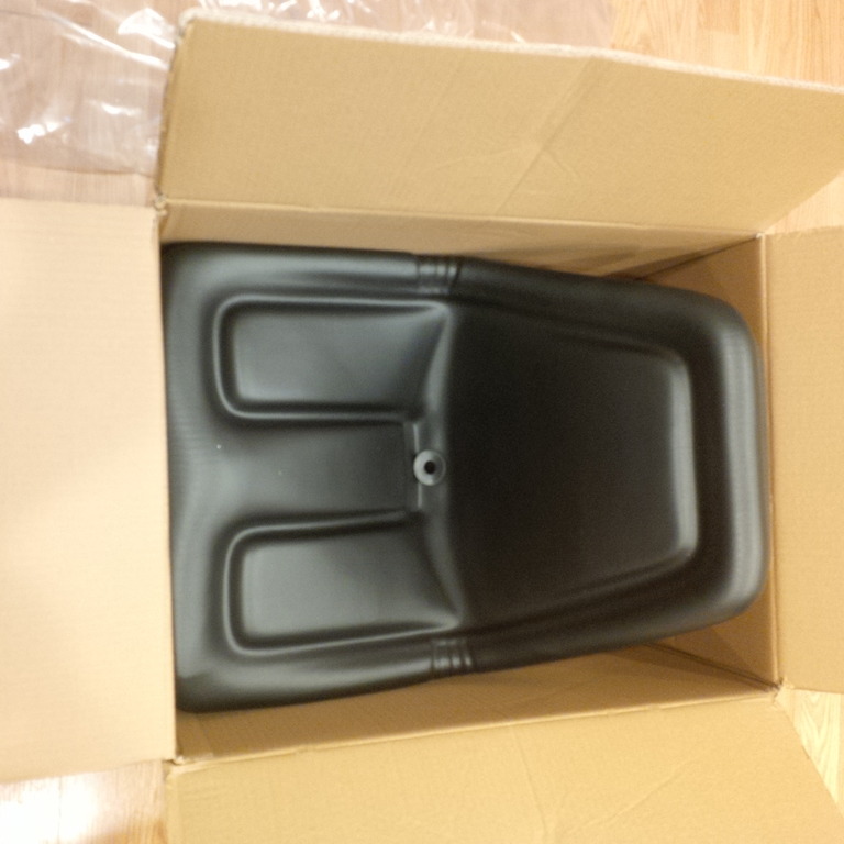

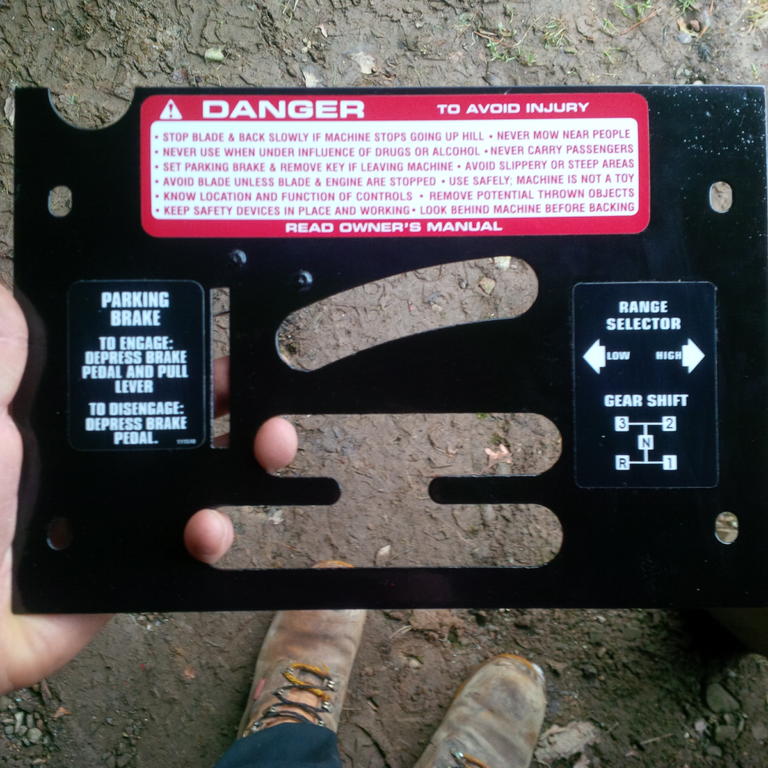

fast88pu 3,393 #30 Posted March 29, 2017 I got some more new parts in the mail today. And also a NOS belt guard. The original seat had one small Crack and was going to use it still but decided not to now. Share this post Link to post Share on other sites

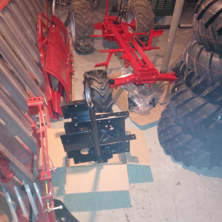

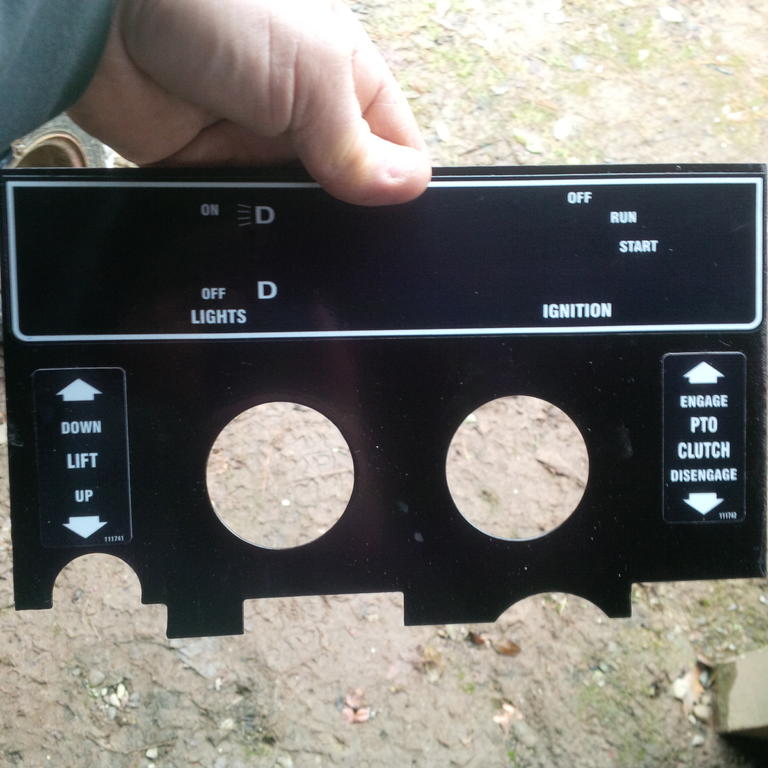

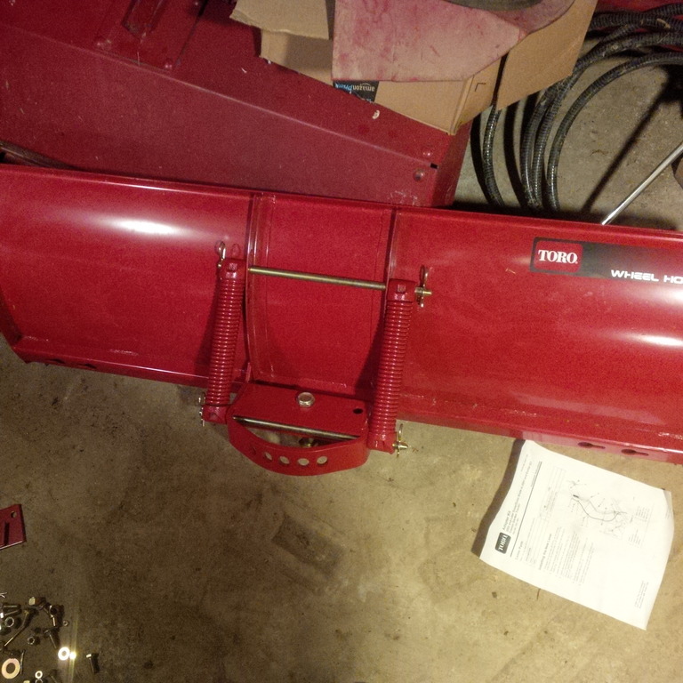

fast88pu 3,393 #31 Posted April 22, 2017 Also got a set of nos hub caps for her. A NOS mule drive. A NOS 48" plow. And also another set of NOS front wheel weights. And decals ar ordered from Terry. 2 Share this post Link to post Share on other sites

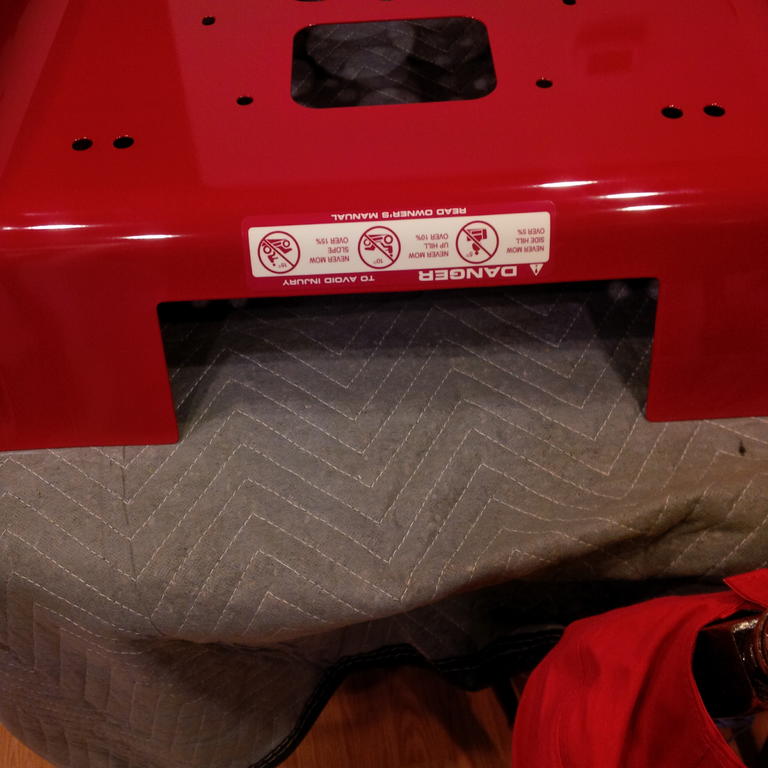

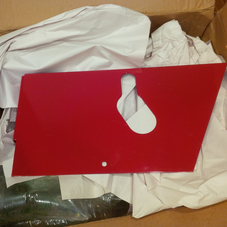

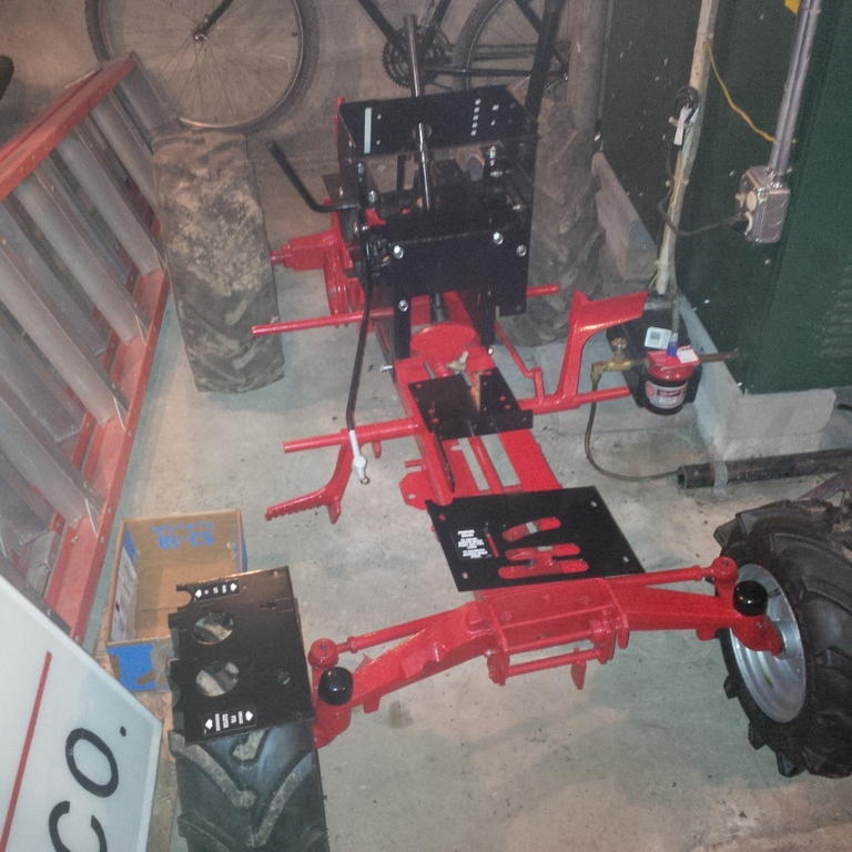

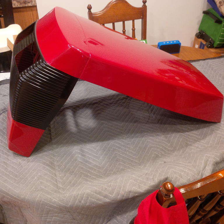

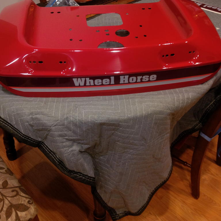

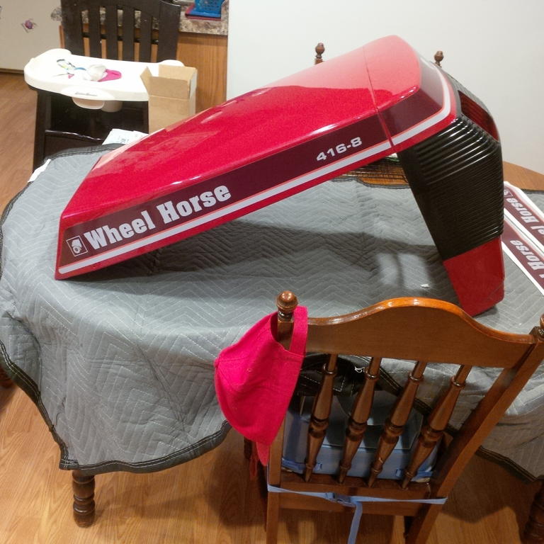

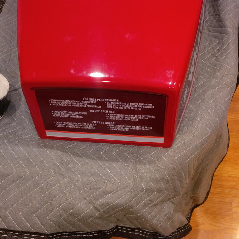

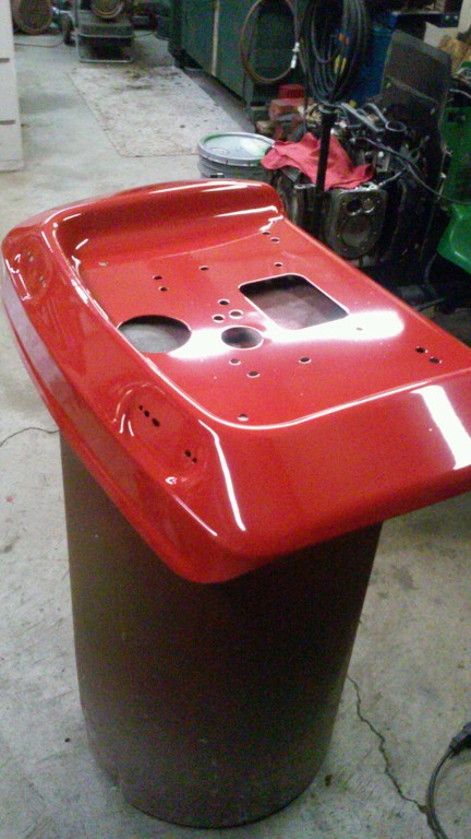

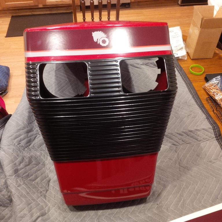

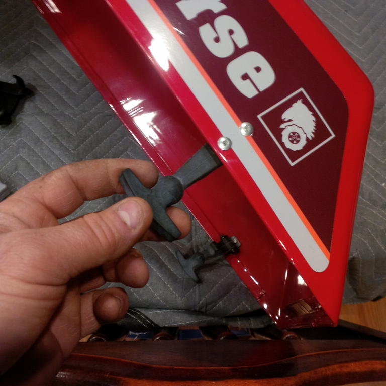

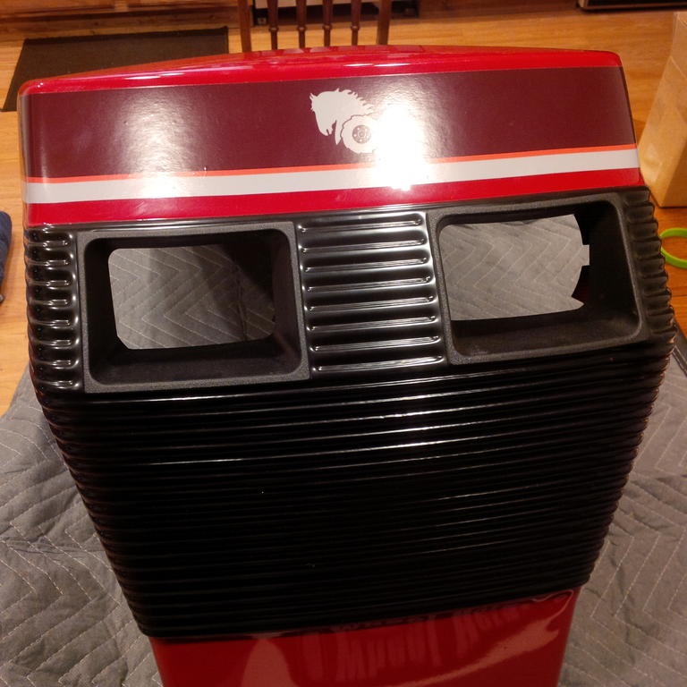

fast88pu 3,393 #32 Posted December 31, 2018 So it's been a long time coming but starting to work on it again now. NOS hood, NOS headlamp bezels, NOS hood straps and Terry's decals on. Built most of the tower and added stickers. Also NOS fender pan too. And time for the eye candy lol. 5 1 1 Share this post Link to post Share on other sites

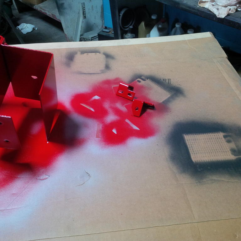

fast88pu 3,393 #39 Posted January 3, 2019 Some of the last parts to paint Share this post Link to post Share on other sites

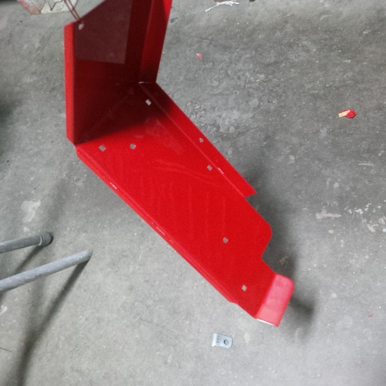

fast88pu 3,393 #42 Posted January 4, 2019 Well since the running boards are NLA in NOS I had no choice but to strip and paint a set. Base Clear RM paint. They look NOS now lol. 2 Share this post Link to post Share on other sites

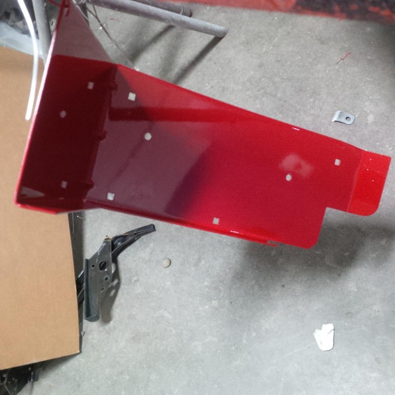

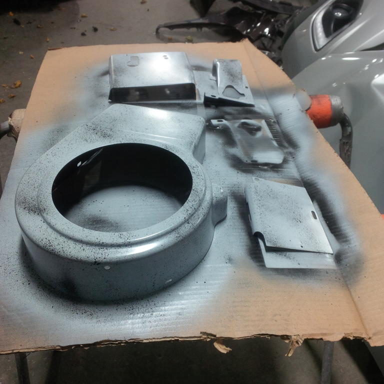

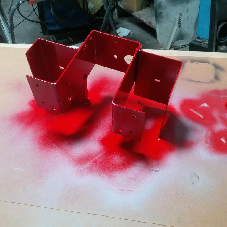

fast88pu 3,393 #44 Posted January 19, 2019 More preping and painting 6 Share this post Link to post Share on other sites

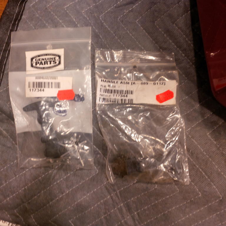

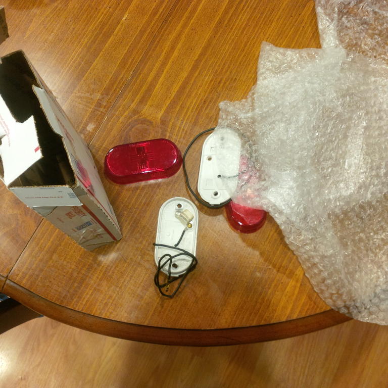

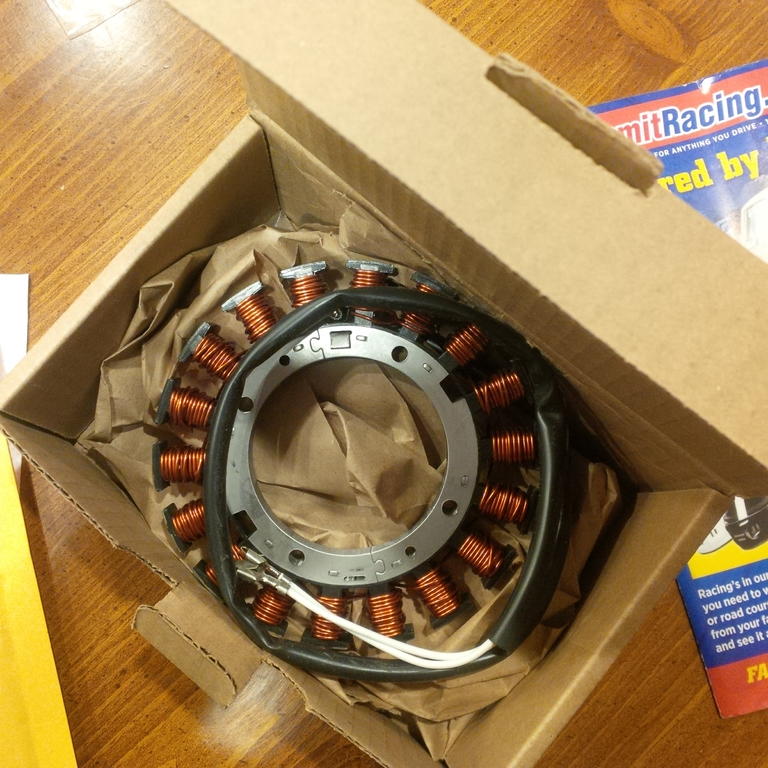

fast88pu 3,393 #45 Posted January 24, 2019 More new parts 2 Share this post Link to post Share on other sites

c-series don 12,140 #48 Posted January 24, 2019 Ahh a dusting of black over the primer to show highs and lows? Somebody knows what they are doing!! Nice work 👍🏻 2 Share this post Link to post Share on other sites
fast88pu 3,393 #49 Posted January 24, 2019 Have to make it nice lol 1 Share this post Link to post Share on other sites
c-series don 12,140 #50 Posted January 25, 2019 I totally agree, if you’re going to do it, take the time and do it right or leave it alone. 1 1 Share this post Link to post Share on other sites
