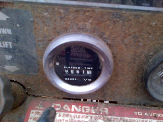

fast88pu 3,372 #1 Posted March 22, 2016 I just picked up a 1987 416-8 with the magnum kohler on it. The hour meter reads 51 hours. Should it have a hobbs hour meter on it ? Because it does not. What are the chances of it being original hours ? 4 Share this post Link to post Share on other sites

Wishin4a416 2,473 #3 Posted March 23, 2016 (edited) Tell Tale signs are the seat, Carb throttle shaft play, steering play and tire wear. If its for real, you just hit the lottery. Good Luck! All my Horses that have meters are Hobbs. Edited March 23, 2016 by Wishin4a416 Share this post Link to post Share on other sites

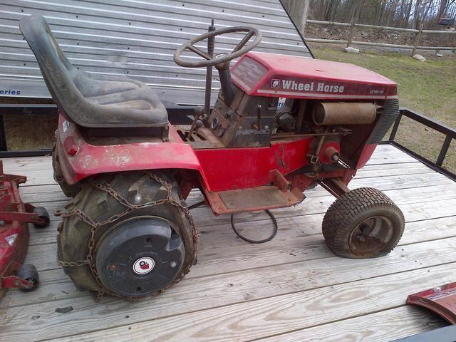

stevebo-(Moderator) 8,604 #4 Posted March 23, 2016 Tractor was left outside for years but from what I saw in pictures (send outside of this post) looks like it could very well me original Share this post Link to post Share on other sites
fast88pu 3,372 #5 Posted March 23, 2016 I sent steve photos. Front tires have nubs still on them but it has sat for 20+ years. Tires are dry rotted. Steering is tight. Could you post up the photos for me steve ? Thank you Share this post Link to post Share on other sites

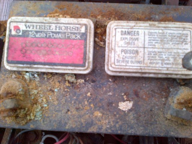

stevebo-(Moderator) 8,604 #8 Posted March 23, 2016 Here are the pictures The fact that the original battery is in it makes me think it is original hours. 12 Share this post Link to post Share on other sites
wallfish 19,400 #9 Posted March 23, 2016 Hmmm original battery, no cracks in original looking seat, not much tire wear, if any and the sheet metal appears all straight. I'm guessing original hours. But of coarse it's easy to swap those battery covers, add new seat and tires (years ago) Share this post Link to post Share on other sites
AMC RULES 37,254 #10 Posted March 23, 2016 ...and then promptly... kick it to the curb for 29 years. 2 1 Share this post Link to post Share on other sites
fast88pu 3,372 #11 Posted March 23, 2016 I doubt the original owner did that. The chains have no wear on them. Share this post Link to post Share on other sites
Wishin4a416 2,473 #12 Posted March 24, 2016 The deck wheels show very little wear also. Share this post Link to post Share on other sites
fast88pu 3,372 #13 Posted March 24, 2016 The belts do not even have wear Share this post Link to post Share on other sites
953 nut 64,340 #14 Posted March 24, 2016 The ribbed rubber foot pads and the belt guard don'[t show any ware and tare and the plastic wheel weights aren't all scuffed up, looks good! Share this post Link to post Share on other sites
c-series don 11,494 #15 Posted March 24, 2016 Ok one of the first things I would to after checking fluids is put a new battery in that baby,turn the key to on and put your ear up to that hour meter and listen for the ticking sound. If it's ticking then it's probably correct given your other discriptions. Even if it's not working it looks like a good score! Good luck 1 Share this post Link to post Share on other sites

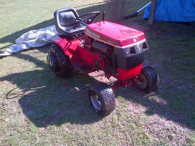

fast88pu 3,372 #16 Posted March 24, 2016 Thank you. I still have to wash it and see how rough it really is. Then probably a restore on it. 2 Share this post Link to post Share on other sites

fast88pu 3,372 #21 Posted March 26, 2016 Off to make the donuts, I mean clean the horse today. 2 Share this post Link to post Share on other sites

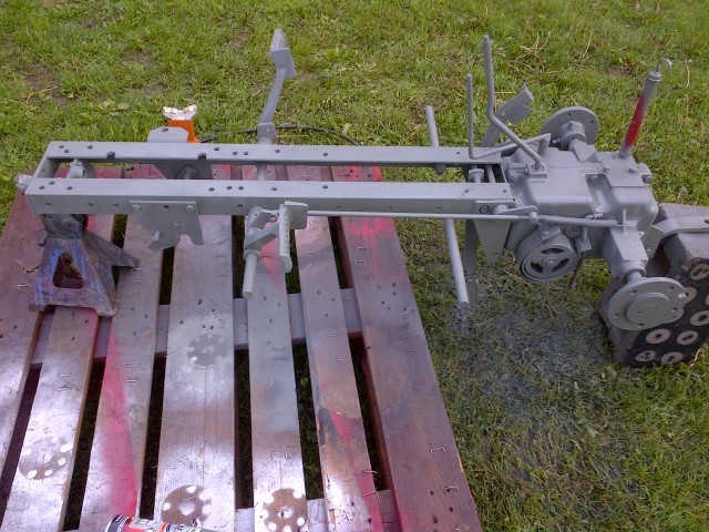

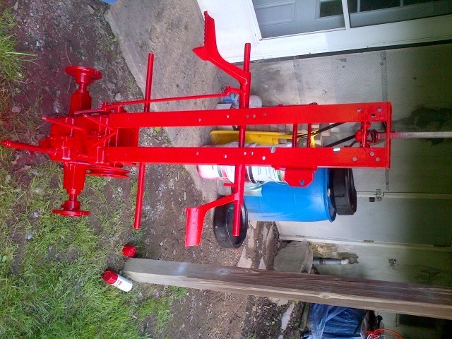

fast88pu 3,372 #24 Posted May 17, 2016 well it is in pieces. blasting it and restoring 9 1 Share this post Link to post Share on other sites
Tankman 3,528 #25 Posted May 17, 2016 Very nice Horse! My opinion, hard to beat the 16 hp Kohler. The 416-8 GREAT! 2 Share this post Link to post Share on other sites
