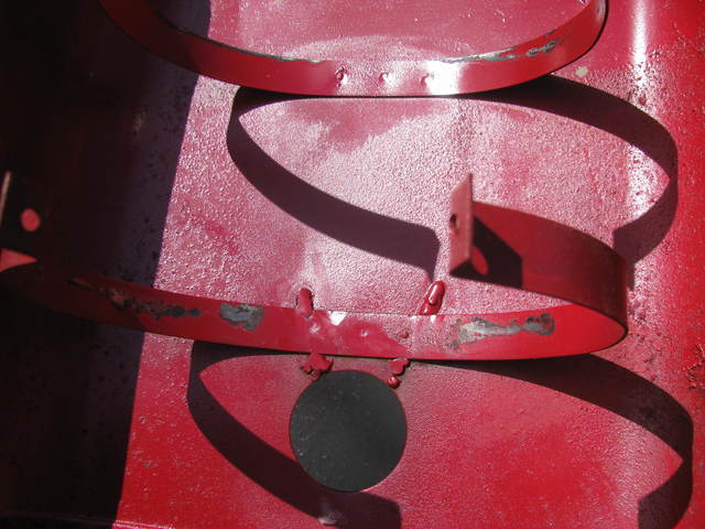

seven 202 #41 Posted April 16, 2016 OK that's kinda what I thought by looking at the old indents on the shaft thxs One more I have the gas tank but have no straps for it.the four holes in the hood are they the holes that mount the straps to the hood Share this post Link to post Share on other sites
AMC RULES 37,260 #42 Posted April 16, 2016 From the factory... the straps were tack welded to the bottom of the hood. Not supposed to be any holes in it, besides the large tank fill hole. 3 Share this post Link to post Share on other sites
