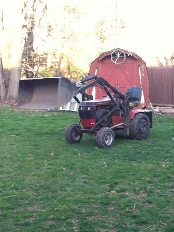

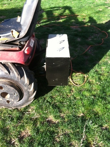

yzf450motoxrider 20 #31 Posted April 19, 2016 figured id give an update. Used the tractor to move 6.5 yards of topsoil. tractor did great. the tach works now. The volt meter reads 11 volts compared the 10 or less it used to be. It turns over much much faster now and starts much easyer. I slso modified the weight box and put deerstone tires on the back and firestone triribs on the front even with around 400lb in the bucket you could easily turn the wheel with one hand. 1 Share this post Link to post Share on other sites
WNYPCRepair 1,923 #32 Posted April 19, 2016 Does it have a loader on it? Share this post Link to post Share on other sites
yzf450motoxrider 20 #33 Posted April 19, 2016 yes ill take a picture tommarow 1 Share this post Link to post Share on other sites
yzf450motoxrider 20 #34 Posted April 19, 2016 the tractor is much more maneuverable with the tri rib tires and a shorter weight box. As far as its electrical problems I don't have much time to work on the tractor anymore but ill get them all fixed eventually. 2 Share this post Link to post Share on other sites
