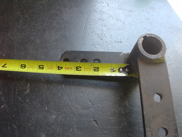

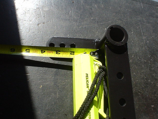

cleat 7,733 #1 Posted March 19, 2016 If you convert a Wheel horse to gear reduction steering and find your mid rockshaft now hits the steering gear, this is why. The gear reduction rockshaft is around 1/4" shorter. Here is a standard non gear reduction rockshaft. And here is a gear reduction rockshaft. Note how all 3 holes are nearly evenly spaced verses the non gear reduction unit which has the outer hole spaced out further. 5 Share this post Link to post Share on other sites

cleat 7,733 #3 Posted March 20, 2016 You may be able to redrill your rockshaft and cut a bit off. I would do the steering conversion then carefully rotate the rockshaft noting any interference to the steering gear before cutting if not needed. 2 Share this post Link to post Share on other sites
