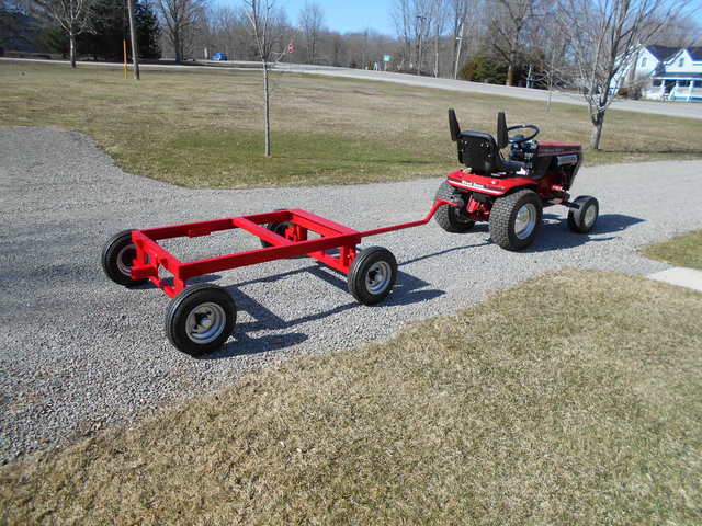

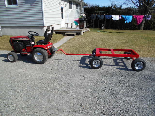

russellmc301 601 #26 Posted March 24, 2016 i cant find any pics but the c-160 loves the hay wagon and pulls it with pleasure. Share this post Link to post Share on other sites
Ed Kennell 45,028 #27 Posted March 24, 2016 You are the Master Mechanic Cleat. Do you think it may have had larger wheels on the rear originally ? 1 Share this post Link to post Share on other sites

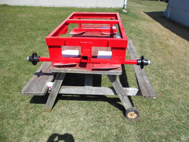

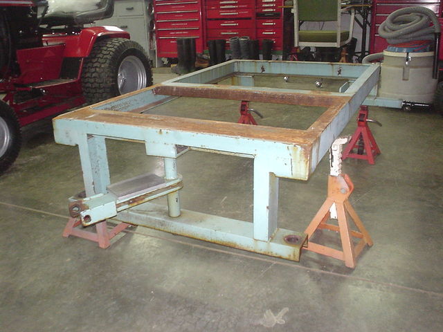

cleat 8,748 #28 Posted March 24, 2016 (edited) No; I raised the front and now need to raise the rear. This was done to gain ground clearance in the front. Edited March 24, 2016 by cleat Share this post Link to post Share on other sites
cleat 8,748 #29 Posted March 25, 2016 18 hours ago, russellmc301 said: i cant find any pics but the c-160 loves the hay wagon and pulls it with pleasure. My buddies say I am crazy for building up this 4 wheeled wagon but I liked them on the Farm and we use them all the time here at work to move piping etc around. Looking forward to using the wagon this summer. 1 Share this post Link to post Share on other sites

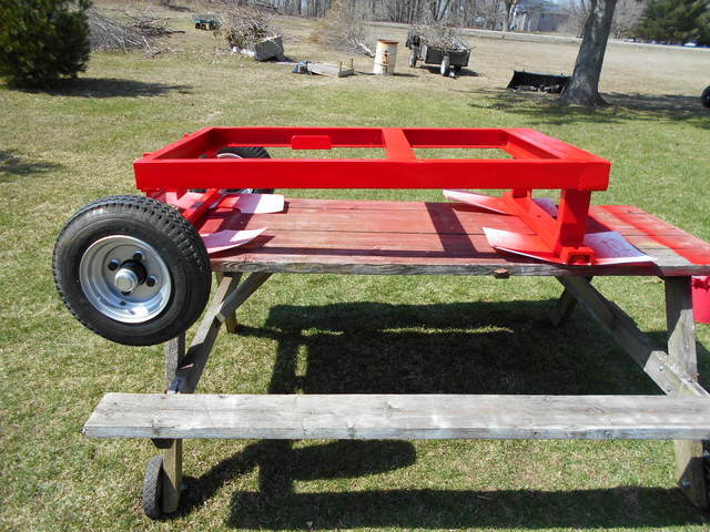

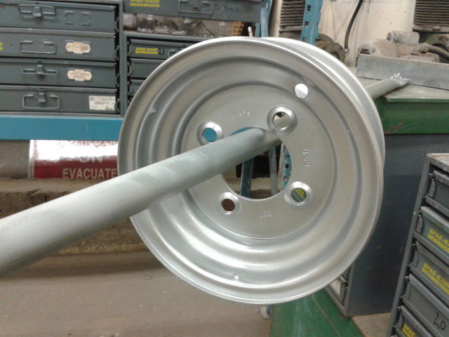

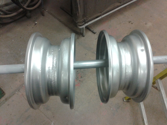

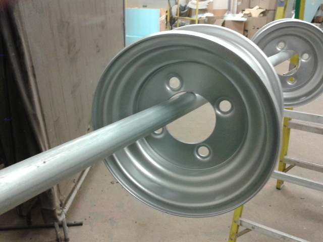

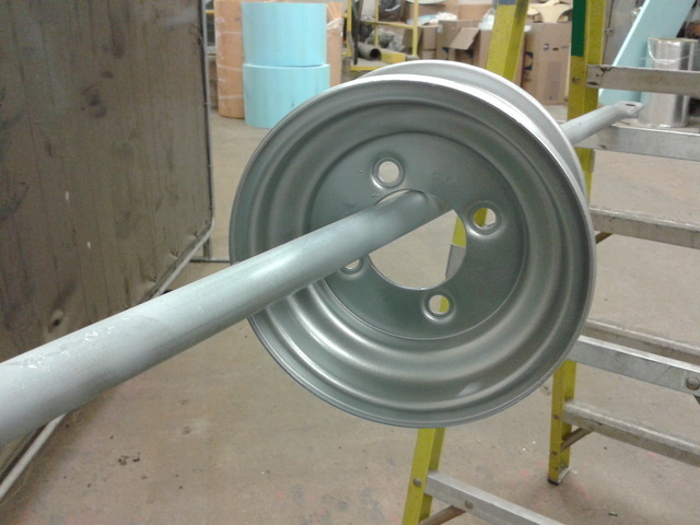

cleat 8,748 #31 Posted March 25, 2016 Rear wheels have just been bead blasted and painted. Tires have been cleaned up and I have new tubes. Once the paint cures for a few days I will assemble. 6 Share this post Link to post Share on other sites
TDF5G 2,073 #32 Posted March 28, 2016 (edited) That's a great way to paint wheels, getting the front, back and inside all at once! Gonna have to remember that! Edited March 28, 2016 by TDF5G 3 Share this post Link to post Share on other sites

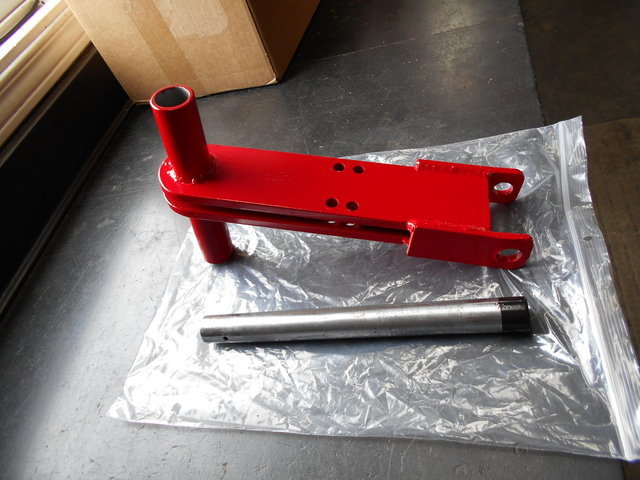

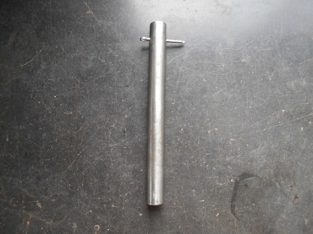

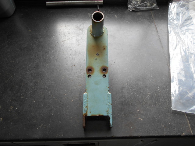

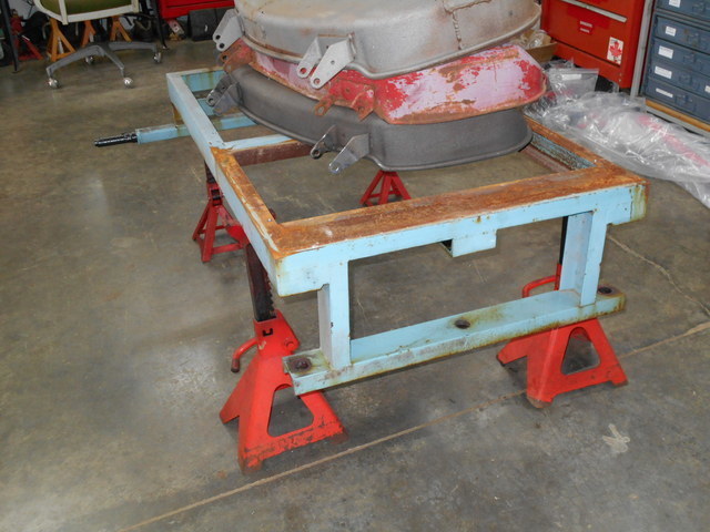

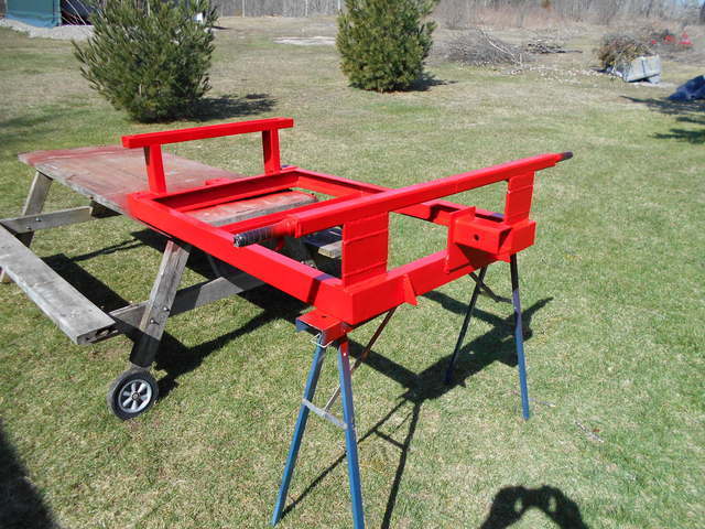

cleat 8,748 #34 Posted April 3, 2016 Finally got the steering pivot out of the frame. Pin was seized into place with nothing else holding it and it stuck out the bottom. Freed up pin, drilled hole for a cotter key to hold it up. Cut it to length then drilled and tapped a 3/8 hole in the bottom for a puller if ever needed. Pivot itself will go into work for bead blasting and paint. 4 Share this post Link to post Share on other sites

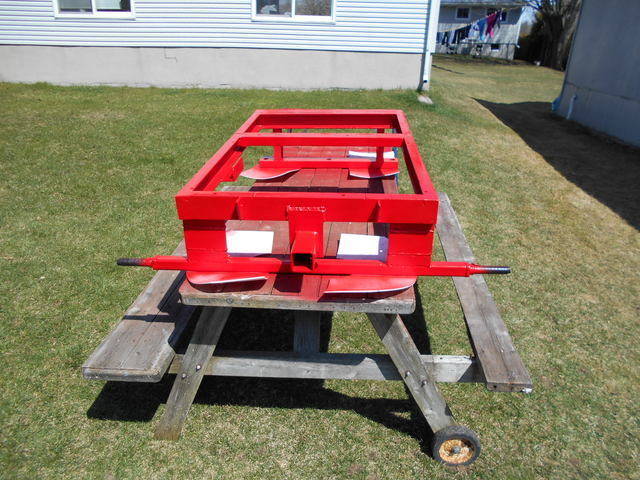

Digger 66 3,525 #35 Posted April 3, 2016 (edited) On 3/19/2016 at 11:03 AM, cleat said: I picked up this old wagon frame from work. Your picnic table has wheels on it , how fast have you had that sucker going ? Edited April 3, 2016 by Digger 66 5 Share this post Link to post Share on other sites

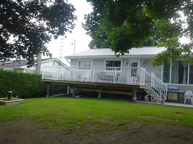

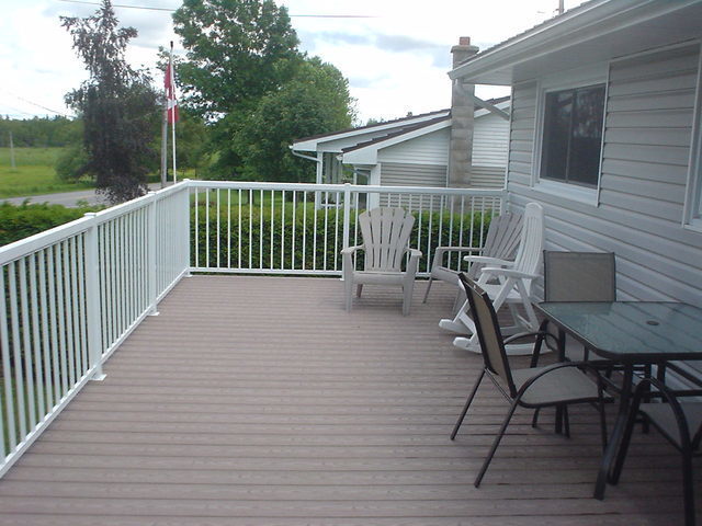

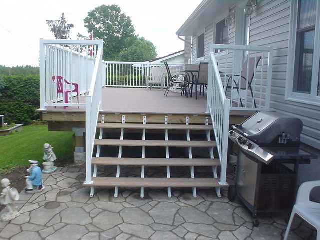

cleat 8,748 #36 Posted April 3, 2016 (edited) Ha Ha. Not too fast. Makes it easy to move around for mowing grass. That poor thing is going to fall apart soon it is so rotten. Makes a good bench for painting and working on, no good for eating at any more. We have a nice table and chairs on the new deck now for that. Edited April 3, 2016 by cleat 5 Share this post Link to post Share on other sites
wallfish 19,379 #37 Posted April 3, 2016 1 hour ago, Digger 66 said: Your picnic table has wheels on it , how fast have you had that sucker going ? How about one of these? Toyed with the idea of building one but haven't gotten inspired enough to do it. http://www.redneckrepairs.com/video/drivable-picnic-table-that-can-do-wheelies/ 5 Share this post Link to post Share on other sites
Ed Kennell 45,028 #38 Posted April 4, 2016 Would that be licensed as a RV ? 1 Share this post Link to post Share on other sites

cleat 8,748 #40 Posted April 6, 2016 Steering pivot and pivot pin have been cleaned up and painted. Pin just has the little bit that will protrude painted, the rest will be heavily greased on assembly. 3 Share this post Link to post Share on other sites

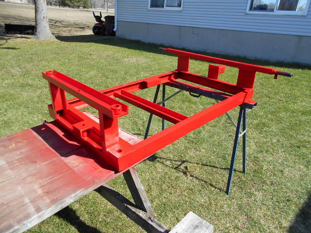

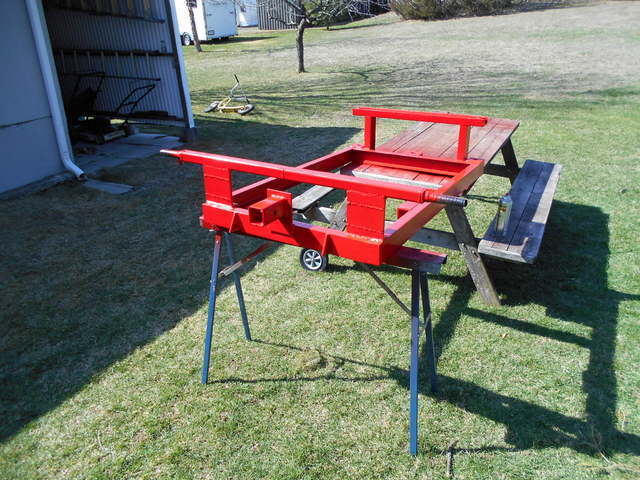

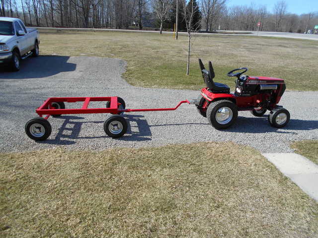

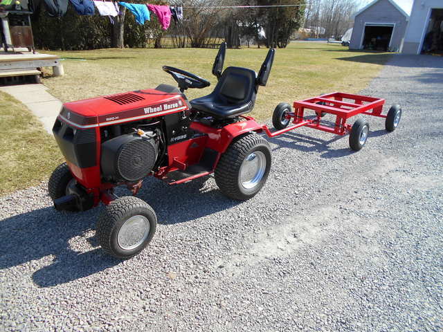

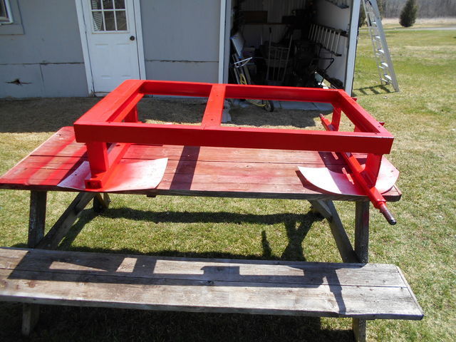

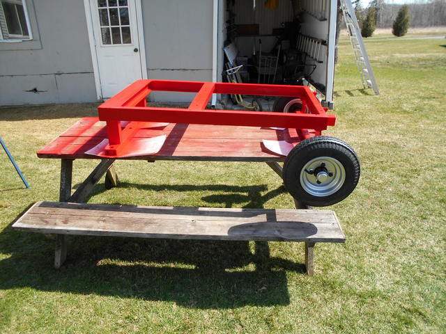

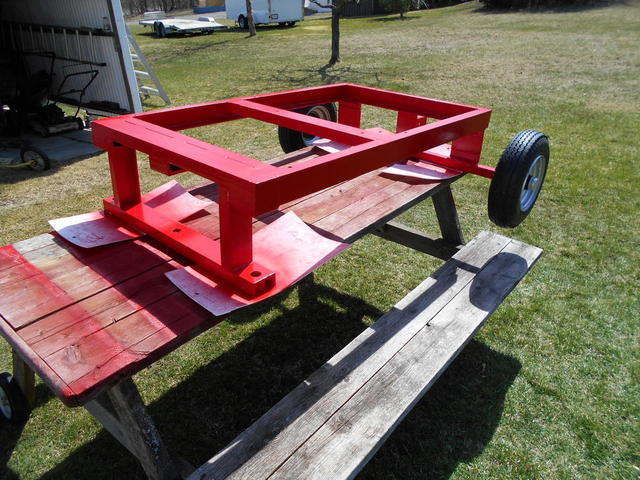

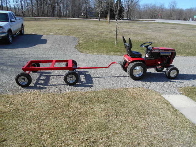

cleat 8,748 #41 Posted April 16, 2016 Rear axle has had plates welded in to raise it by 3". Frame was then sanded and fully primed. Bottom has 2 coats of red paint. A receiver hitch was welded onto the rear of the frame for either hooking up a trailer like a train or for pushing while someone steers the front. 3 Share this post Link to post Share on other sites
19richie66 17,819 #42 Posted April 16, 2016 very nice work 1 Share this post Link to post Share on other sites

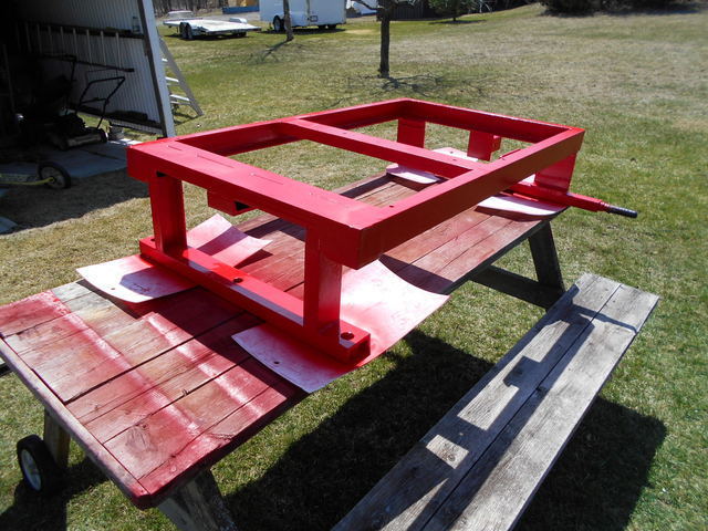

cleat 8,748 #43 Posted April 16, 2016 Frame flipped, sitting on pieces of teflon to protect paint on bottom. Top of frame then painted. 4 Share this post Link to post Share on other sites

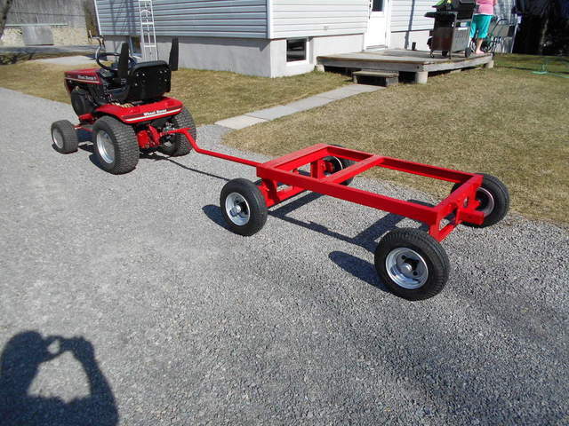

cleat 8,748 #44 Posted April 16, 2016 (edited) Rear hubs and wheels installed. Edited April 16, 2016 by cleat 4 Share this post Link to post Share on other sites

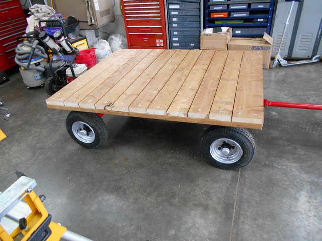

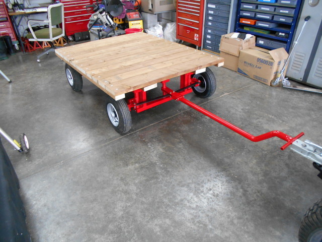

cleat 8,748 #45 Posted April 16, 2016 Wagon frame completely assembled. Just need to build the wood deck and sides. 7 Share this post Link to post Share on other sites
woodchuckfarmer 333 #47 Posted April 17, 2016 Are you going to build a nice oak bed with sides and urethane it ? Would look cool . Wayne 1 Share this post Link to post Share on other sites
AMC RULES 37,254 #48 Posted April 17, 2016 (edited) Kinda thinking... some strategically placed diamond tread aluminum might look pretty cool too Cleat. When all polished up, would really set off that beautiful red. Edited April 17, 2016 by AMC RULES 2 Share this post Link to post Share on other sites

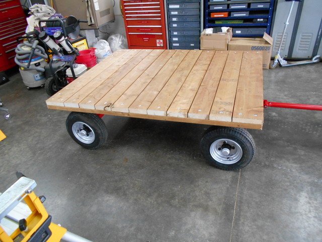

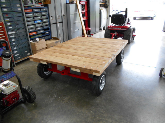

cleat 8,748 #49 Posted May 4, 2016 Deck is built. No sides yet. 7 Share this post Link to post Share on other sites
