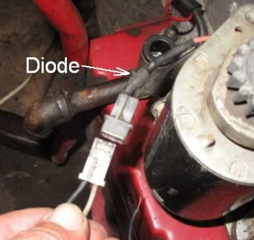

Save Old Iron 1,573 #11 Posted March 19, 2016 (edited) 5 hours ago, russellmc301 said: What is a vertical onan and reaming head light wire and the wire with the bulge were does that come out of. the engine turns over and all we need is spark to get it to go. forget I mentioned the Onan - I have been working with another member on a different tractor with a different engine - looks like I mentally got my wires crossed. The pic below is a very typical Briggs configuration of two wires that support charging and headlights. The "bulge" in one wire is a diode that supports the charging circuit and the "remaining" wire is the headlight wire. The mag wire should be the third unidentified wire - disconnect this wire from the magneto, crank the engine and observe if a spark is present when the engine cranks over. Since you saw smoke and the engine doesn't fire up, it would be a reasonable guess the magneto has burned up from touching a battery powered wire to the mag kill wire. Edited March 19, 2016 by Save Old Iron 2 Share this post Link to post Share on other sites
russellmc301 601 #12 Posted March 19, 2016 thanks, when they put a new silinod on they messed with the wiring some so it doesn't have a male and female connector. i have another 9 hp brigs and ill look at that. Is that a snapper? looks a lot like one from the picture. 1 Share this post Link to post Share on other sites
Save Old Iron 1,573 #13 Posted March 20, 2016 14 hours ago, russellmc301 said: Is that a snapper? looks a lot like one from the picture. No idea on that observation, I just pulled a random picture from a Google search to illustrate the bulge. Once again, you don't need either of these connections functioning to check for spark. 1 Share this post Link to post Share on other sites
