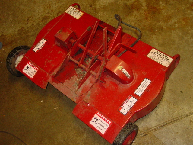

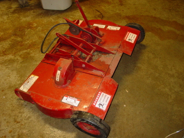

eibbed 63 #1 Posted March 16, 2016 Gentlemen, I have a mower deck that came off of a 62/63 Lawn Ranger. Will I be able to use it on my 702? Dave 3 Share this post Link to post Share on other sites

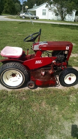

slammer302 2,156 #6 Posted March 16, 2016 here's a pic of the one on my 502 2 Share this post Link to post Share on other sites

eibbed 63 #8 Posted March 16, 2016 (edited) Gentlemen, Thanks for all of your pictures and informative replies to my posting. There is no model number on the deck. I have decided not to adapt it to my 702. Instead, I am going to sell it. Yes, I have met Steve. Great guy. Cordially, Dave Edited March 16, 2016 by eibbed 3 Share this post Link to post Share on other sites
