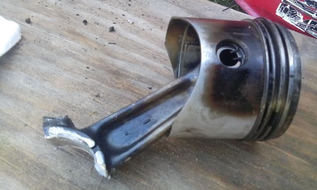

Sokniw 13 #8 Posted March 14, 2016 Oh yeah it ran like a champ before the "Rod Blew" i attached a picture of what happened, it was actually being used to mow when it happened. So i was going to measure make sure i get the right rebuild kit and possibly dig into it, i was hoping to get a replacement engine swap it out. and rebuild one while we had a working one in it. 3 Share this post Link to post Share on other sites

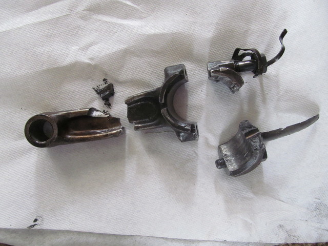

Ed Kennell 44,619 #9 Posted March 14, 2016 Here is the rod I replaced. 3 Share this post Link to post Share on other sites
Sokniw 13 #10 Posted March 14, 2016 Maybe ill give that a shot, and just replace the rod, i still need to get the bottom half of the rod out of the block, it was getting cold when i started digging into this so it was kind of left over the winter. I dont mind doing an engine swap wouldn't mind getting a little more power out of it. Some of the things people do to these are pretty crazy and cool. 2 Share this post Link to post Share on other sites
Ed Kennell 44,619 #11 Posted March 14, 2016 You must make sure you get all the broken parts removed and remove all the aluminum that will be galled to the crank and measure to confirm it is in spec. There are many threads on here on cleaning the crank. Some use acid and some use emery cloth as I did. 2 Share this post Link to post Share on other sites

can whlvr 994 #14 Posted March 14, 2016 not to be negative but that looks like a lot of blow by on the skirt of the piston,which means rings are worn,which usually means piston will be worn and the cylinder,I would rebuild it proper if you want it to be reliable and last,after all its 40 years old,she deserves that,and it was your wifes grandpas,so you get the go ahead to make it right,of coarse that's my opinion only,but rebuild kit for 100,and 150 machine shop makes for a cheap but amazing engine that will last along time 4 Share this post Link to post Share on other sites
Ed Kennell 44,619 #15 Posted March 14, 2016 I agree , the picture does indicate blow by. That is why I asked if it ran good without smoke. If you do use any of the existing old parts , I repeat, they must be cleaned properly and inspected carefully to determine if they are within specs. One caution, If you do buy a new piston, do not machine the bore until you have the new piston in hand so the bore can be machined to match the piston. New pistons are not always in spec... especially those from our friends on the other side of planet earth. 3 Share this post Link to post Share on other sites

prondzy 3,889 #17 Posted March 14, 2016 9 hours ago, ekennell said: Here is the rod I replaced. I just wanted to point out, notice the vertical grooves just above your top ring. This is a sign that your bore is out of round and might be part of the reason your rod broke (too much rocking action in the bore). I would have deffinately machined that one. Not to say that it won't run with a new rod but the kohler manual shows pictures of this type of wear as an indicator of a worn piston and bore. 1 Share this post Link to post Share on other sites
Howie 900 #18 Posted March 15, 2016 Some of that above the top ring is from carbon buildup on the cylinder wall. I have seen a lot of these worn there and have no marks on the skirt of the piston. There is still a good chance that the cylinder is out of spec.Need to check that good along with the crank pin diameter. Share this post Link to post Share on other sites
rmaynard 16,837 #19 Posted March 15, 2016 (edited) The vertical grooves above the top ring are from pre-ignition, indicating that your timing is off slightly. They are also thought to be caused by carbon build up in the combustion chamber, but I have seen them on pistons where there is little or no carbon. They will always be on the side closest to the spark plug. These grooves usually aren't serious enough to affect the performance of the engine. Edited March 15, 2016 by rmaynard 4 Share this post Link to post Share on other sites
