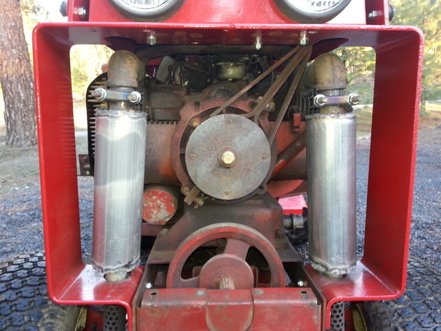

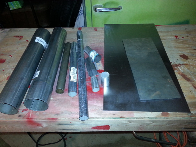

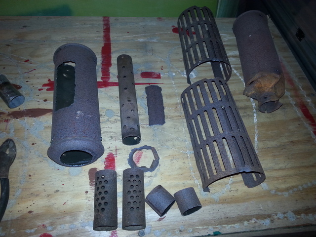

JerryV 16 #1 Posted March 14, 2016 So I finally got my D-200 put together. I decided to knock together some mufflers instead of trying to hunt down another nos muffler to match the one I have. I used the inner parts of the old mufflers some sheet metal and some 3inch exhaust pipe. 9 Share this post Link to post Share on other sites

roadapples 6,983 #5 Posted March 14, 2016 Nice work and Share this post Link to post Share on other sites
JERSEYHAWG / Glenn 4,498 #6 Posted March 14, 2016 Great job, intuitive and inventive. Glenn Share this post Link to post Share on other sites
pfrederi 18,644 #7 Posted March 14, 2016 Nice idea wish my welding skills were good enough to tackle something like that. Share this post Link to post Share on other sites
JerryV 16 #8 Posted March 15, 2016 After several hours of running they are holding up. If I ever need to make another set I think I'm going to source all the material from my local metal dealer and have all the pieces cut on a plasma or water jet table especially the end caps. Share this post Link to post Share on other sites
