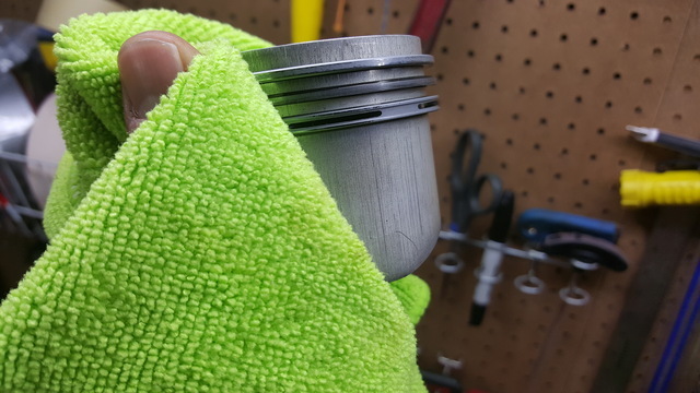

Your Shirtless Neighbor 2 #1 Posted March 13, 2016 I just got her all back together. New piston, rings, connecting rod, and rebuilt the carb... so far $120 into this "free" motor. Filled the oil to the middle of the full marks, and it fired up. Instantly it was smoking. I can't adjust the carb worth a damn and it won't rev. I did remove the governor.... and I checked my vent valve, all seem to be OK. I let it run. For a good 5 minutes billowing smoke. The cylinder was in spec at 2.6" diameter.... What am I missing?! Just a bad motor? After 5 minutes the side of the carb and air cleaner were black... The oil has a slight haze to it, but it's clean. Also, piston rings are staggered.... just to rule that out. The ONLY difference between the old and new piston is the new one didn't have that wavy spring ring. The old piston had it under the lower compression ring. Is this supposed to go under the oil ring? Share this post Link to post Share on other sites

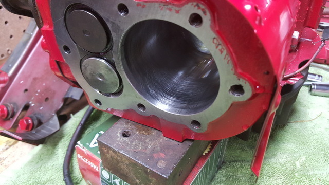

Your Shirtless Neighbor 2 #8 Posted March 13, 2016 (edited) Crank case vent/valve vent is working. New gaskets, cleaned the mesh. It's venting to the carb, no excess oil really. Bore was checked with vernier top and bottom. Center was checked with a ring and shims. Edited March 13, 2016 by AimlessMoto Share this post Link to post Share on other sites
squonk 45,364 #9 Posted March 13, 2016 (edited) Bore really needs to be checked with a bore gauge or inside/ outside micrometers. Cyl. Is probably out of round and tapered out of spec. Edited March 13, 2016 by squonk 3 Share this post Link to post Share on other sites

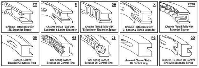

Molon_Labe 731 #14 Posted March 15, 2016 If your wavy (expander) ring is the same width as the oil ring groove it should go under the ring as in figure GO below Share this post Link to post Share on other sites

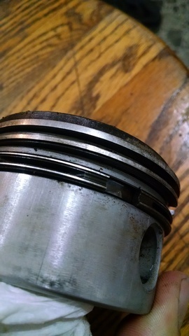

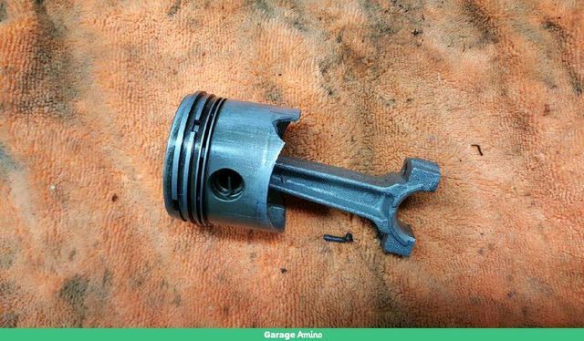

Your Shirtless Neighbor 2 #17 Posted March 15, 2016 (edited) Ok... my piston that came out had 3 rings and 1 spring. An oil ring with large holes on the bottom. The middle ring with a square notch cut out of the bottom section and the spring under it. And the top ring, which is solid. The way it came out was EXACTLY like that picture, EXCEPT for the spring under the oil ring.... which is probably what led to the original failure. ... The new setup is a slotted oiler ring on the bottom... double bevel center ring... single chamfer top ring... I think I have to pull this thing apart, maybe use the stock rings if they're in spec, and put the damn spring correctly under the oil ring. Edited March 15, 2016 by AimlessMoto Share this post Link to post Share on other sites
Your Shirtless Neighbor 2 #18 Posted March 15, 2016 This is the original as it came out. Share this post Link to post Share on other sites
squonk 45,364 #19 Posted March 15, 2016 (edited) I see enough scuffing on that old piston to tell me that block probably needed boring. Every engine I ever worked on had the wavy expander under the oil ring. I just never worked on Tecky innards.Looks like someone got in there before you and meesed things up Edited March 15, 2016 by squonk 1 Share this post Link to post Share on other sites

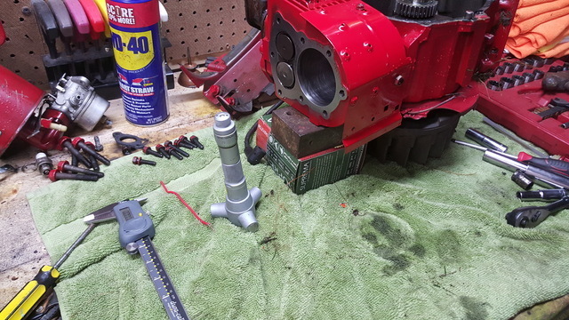

Your Shirtless Neighbor 2 #23 Posted March 16, 2016 HAHA! I think I got this. I put the center ring in upside-down! Attached is a pic of the piston as it came out... I also double checked all my rings at 4 different heights in the bore... on average all gaps came out to .010, the bore with a gauge spun 3 times at 3 depths averaged 2.623. The piston itself is 2.607. All seem to be within spec, and the bore was only out of round by less than a thou. I'm still going to take it to a local small engine shop so the can check the engine code and see if it needs the spring under the oil ring. Hopefully it's just the stupid wiper ring. Share this post Link to post Share on other sites
squonk 45,364 #24 Posted March 16, 2016 I would have him check that bore if I were you. Using a ring is not accurate. 1 Share this post Link to post Share on other sites
Your Shirtless Neighbor 2 #25 Posted March 16, 2016 4 hours ago, squonk said: I would have him check that bore if I were you. Using a ring is not accurate. You should your coffee before posting. I clearly have a pic of a bore gage, and stated my measurements. I also checked ring gap. Share this post Link to post Share on other sites
