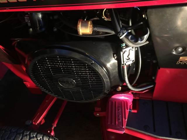

Phatboy 565 #1 Posted March 13, 2016 (edited) Ok guys the oil and grime mess ws caise by a poorly designed oil drain extention,, it is lose in the block and causing a leak,, so can some one please show me a picture of the proper way to make this extention ,, or how to fix this one so it stays tight and doesnt leak,, it had oil and grim all over the block it was a dam mess ,, i hate how hard it is also to remove the shroud,,, i really need to know how to properly extend this,, thanks guy ,, dont know how id tackle this project with out your help... Sorry no matter what i do pic for drain is upside down,,, Edited March 13, 2016 by Phatboy Share this post Link to post Share on other sites

JAinVA 4,638 #3 Posted March 13, 2016 (edited) If the nipple is leaking at the block you need to remove all but that nipple and tighten it back up.I would not use any teflon tape or ribbon dope there.You can pull that nipple and clean the block threads(brake parts cleaner) and the nipple thread.You can apply what a lot of older timers used for pipe sealant,just plain old enamel paint brushed onto the male threads What you have looks stock to me.What was modified?Luck,JAinVA Edited March 13, 2016 by JAinVA Share this post Link to post Share on other sites
Phatboy 565 #4 Posted March 13, 2016 (edited) Is that stock ?? I have seen so many different versions i have no idea,, i just went and tried to take end piece off so i could get the nipple out of the block and it wont turn,, now im worried about screwing up the treads in the block trying to get that apart... I should of just dropped it off at my local dealer this is really getting me upset... Edited March 13, 2016 by Phatboy Share this post Link to post Share on other sites
JAinVA 4,638 #5 Posted March 13, 2016 I have 3 Onans,2 216 and a 220.They all have that setup.Is the nipple leaking at the block? If that is the case and you can't remove it then you have three choices.You can replace the crankcase,live with the leak or clean the area around nipple/block and apply JB weld.There is almost no pressure there so it might stop the leak.JAinVA JimAnderson Glucester,Va Share this post Link to post Share on other sites

ericj 1,579 #9 Posted March 14, 2016 you have to back hold the nipple to get the cap off it's not that difficult. i have loosened the motor and turned it for easier access. i use soft set pipe dope the yellow stuff, works great . good luck eric j 1 Share this post Link to post Share on other sites
Phatboy 565 #10 Posted March 14, 2016 (edited) 38 minutes ago, ericj said: you have to back hold the nipple to get the cap off it's not that difficult. i have loosened the motor and turned it for easier access. i use soft set pipe dope the yellow stuff, works great . good luck eric j I got the cap off and changed the oil yesterday ,, that was easy, i noticed grime around the block and a few of the guys suggested to take shrowd off and clean behind it,, so i did ,, the problem is that the part that screws in to the block for oil drain is very loose and i cant tighten it cause the piece that is at the other end of the nipple wont come off so i can turn and tighen the part that goes in The block...that is the problem,, i checked all the bolts on the engine all tight ,, the back of the flywheel does not have any oil on it,, but below it on the block did and all around the back side and pto side did also,, there was even oil grime on the muffler bracket so the only loose thing that i could find that was loose is the drain tube so i have to start there,, so all that being said once the dealer gets it all straight and fixed i am very diligent as far as keeping thing s the way they are supposed to be,, it be well maitained after that,, ill have time to learn what i need to, to do it the right way...and be able to do what is nessasary,, but i have not had it but 2 days and is why i wanted one that was perfect as can be expected so i would have time to learn..well even with only 400 hours on it ,, it still has a cpl of issues... As to why i came to you guys for help... Edited March 14, 2016 by Phatboy Share this post Link to post Share on other sites

Martin 2,133 #13 Posted March 14, 2016 8 hours ago, Phatboy said: Yes it is leaking at the block,, the end piece of pipe is the piece of pipe that wont unscrew where the plug is and im affraid by putting to much pressure on it might screw up the threads in the block,, im going to have my local kubota/ wheel horse dealer come get it and fix it,, before i cause damage,, boy i tell ya one thing i love this 520,, but my 310 was a hell of alot easier to work on i hate the design of this engine, and pooly designed oil drain is a prime example.. That drain design has been used on many models since the 60s so it is not a design that is just limited to the 520 or Onan in general. I agree it is not the best design and looks ugly with all the fittings. The easiest way to deal with this (something that you can fix yourself, very easily) is to remove the drain pipes (nipples) and elbow, piece by piece and seal it as you reinstall. First, drain the oil from the engine. Next, you will have to deal with the 4 engine pan bolts that attach the engine to the plate on tractor frame, loosen the front ones until the nuts are flush with the ends of the bolts, take the rear ones out all together. Now raise the rear of the engine and place a wedge of wood or similar block of something under the pan to provide just enough clearance to get that elbow to rotate without hitting the plate. Now remove all of the drain pipe components, piece by piece. Clean old thread sealant from pipes and oil pan. Check threads for any damage or stripped condition. Hopefully over the years the nipple that threads into the engine pan hasn't been tightened so much as to damage the oil pan. The two pipe nipples are easily bought new if they need replacing as is the elbow and cap. Most times all that is needed is to clean the threads and reinstall piece by piece using thread sealant that is oil resistant. More than half of my horses (from the 1965 875 right up to the 1995 416s) have been purchased with this design of drain leaking. The biggest problem with the Onan engine is that it is aluminum, the pipes come loose more often than the cast iron pans of the Kohlers. With the aluminum though, the threads are more susceptible to loosening and damage. 2 Share this post Link to post Share on other sites
lynnmor 8,258 #14 Posted March 14, 2016 I replace the nipple going into the block with a new one so that I have fresh threads. If it has been operated with the nipple being loose, the threads will be "polished" and would have to be given a full turn to tighten. That full turn would probably be way too much risking a crack in the aluminum. When installing the new nipple, I clean the threads COMPLETELY with the tractor raised in the rear to prevent oil drips. I use red high strength thread locker on the clean threads. 1 Share this post Link to post Share on other sites
Bow_Extreme 580 #15 Posted March 14, 2016 This is a common problem with Onan Engines. It's no big deal. I find it easiest to remove the 4 engine mounting bolts so the engine is free to move. I always disconnect the drive belt and remove the drive belt cover. Drain the engine oil first and slightly tip the motor to drain out enough oil that it doesnt leak out when you remove the nipple pipe. I use a fairly expensive high pressure sealant that is stable in oil and gas areas and coat the threads. This sealant can be bought nearly anywhere including Lowes. Once coated, thread that nipple back in and tighten it up. Do not over tighten!! Once the sealant sets up that nipple is not going anywhere. These engines are not mounted to rubber bushings so the vibration in the motor tends to loosen these oil drain pipes up. If you want, you can also buy a quarter turn valve from the Toro dealer for $25 and screw that on there. Then you attach a hose when you want to change the oil, turn the valve and your oil will drain. 1 Share this post Link to post Share on other sites
Phatboy 565 #16 Posted March 14, 2016 All fixed now ,, took engine bolts out and lifted up and spun off old nipples ,, amd went to lowes and got new with a shut off valve for changing oil red one to lol. But dealer said it was gonna be 2 weeks to get it in so i just saod screw it ,, called my brother and we knocked ot out , all done and shinny again.. 5 Share this post Link to post Share on other sites
