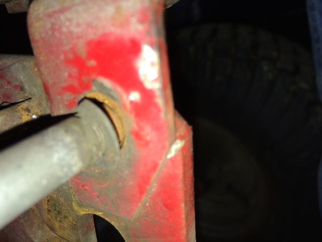

Amcwheel85 2,060 #1 Posted March 13, 2016 Ok after getting my tractors out today I finally remembered the hood on my 310-8 wobbles like crazy, I know why as the hole where the rod goes through to hold hood/grille on has worn and is a lot bigger the the rod now. My question is what's the best and easiest way to fix this? Thanks for any help! Share this post Link to post Share on other sites
cleat 9,312 #2 Posted March 13, 2016 I drilled the hood hinges and front tach bracket where they attach to 1/2". Then make up a new 1/2" rod with a couple of cotter keys to hold them (I don't have a lathe to cut a groove for an e clip). Hood is now nice and tight and the 1/2" rod will wear longer than the original smaller rod. 6 Share this post Link to post Share on other sites
