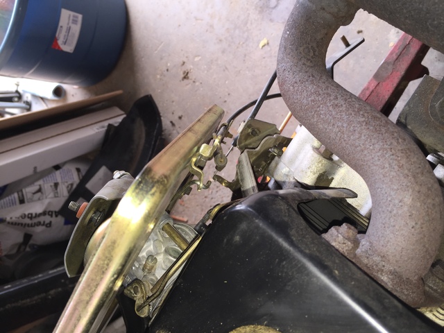

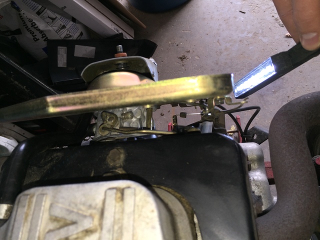

So I put everything back together best I could figure it should go and I've got something wrong when it comes to the Choke cable linkage, the choke cable lever doesn't move as freely as it used to and the butterfly on the carb doesn't open or close completely. I took the best pic I could of the way I set it up but does anyone out there with the same engine setup mind snapping a couple pics of how it's setup on theirs? I'm sure it's something simple I'm doing wrong but I can't for the life of me figure it out.

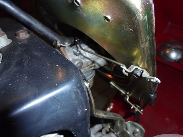

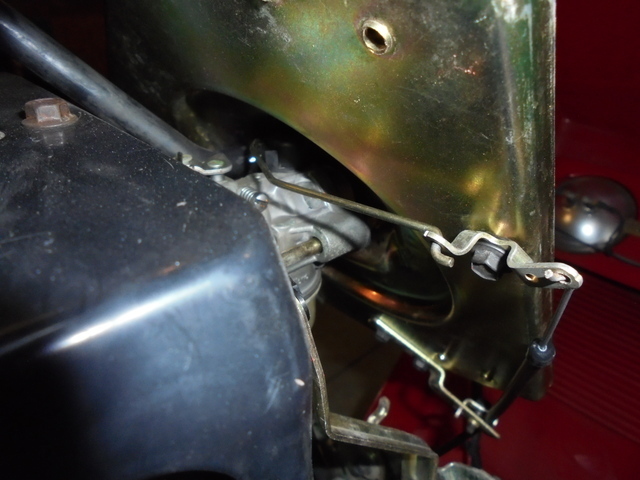

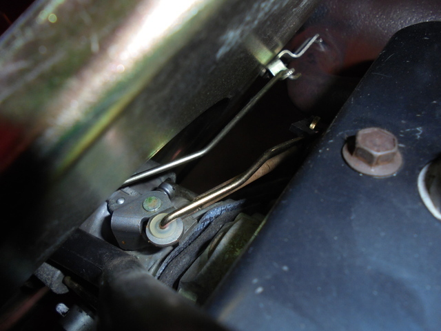

So I would like to give a big shout out to Jim (jgun45879).  I did some searching on here for people who owned the same year and engine tractor as me after not getting any replies on this thread. Not only did Jim offer to take pics of the linkage and send it to me.  He went out of his way to get it out of storage and in his shop so he could take the pictures.  The pictures were exactly what I needed and I was able to get every thing hooked up in under 5 minutes and the horse fired right up!!  It's people like this that make this forum a great resource.  I'm going to post the linkage pics in case someone else needs them in the future.  Thanks again Jim!
