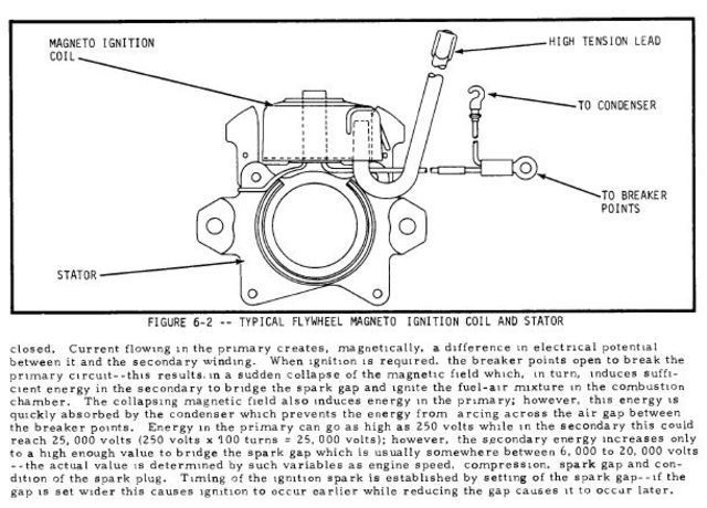

pfrederi 19,868 #2 Posted March 12, 2016 No coil but you have points... must be a magneto points system. (In the late 60s Kohler used 3 different ignition systems.) Does the engine turn over?? For a Mag system all the ignition switch does is ground out the magneto when you turn it off. the M terminal on the switch should show continuity to ground when the switch is off. There should be no continuity in the run.start position. To be sure what is the spec number on your engine. Share this post Link to post Share on other sites

pfrederi 19,868 #6 Posted March 12, 2016 Sounds like a magneto system. You will not see the "coil" it is under the flywheel. The wire from the ignition switch is a ground that is activated in the off position. It grounds the points (and condenser) thus the magneto stops out putting stopping the engine. you do NOT want to feed current in that wire you will fry your magneto. The stator and magneto under the flywheel generate spark any time the flywheel is moving...unless it grounded by the small wire. Why did you replace teh condenser?? Check and make sure your ignition switch grounds the wire in the off position and is an open circuit in run/start. Share this post Link to post Share on other sites

gwest_ca-(File Mod) 11,993 #10 Posted March 12, 2016 Magneto ignition is self-powered. Do not allow any power into the ignition wire as that will blow the coil. Disconnect the ignition wire that goes to the ignition switch and isolate it from the metal chassis. It should run and if it does you can shut if off by grounding the ignition wire to the chassis metal. The ignition switch simply grounds the ignition wire to shut the engine off. Garry Share this post Link to post Share on other sites
