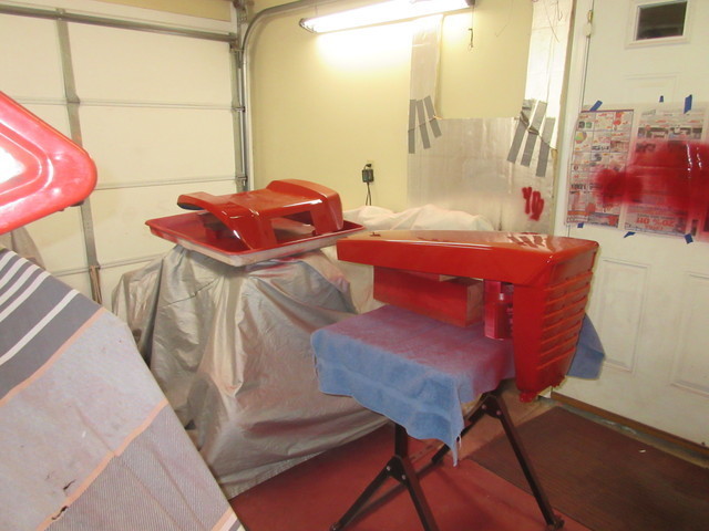

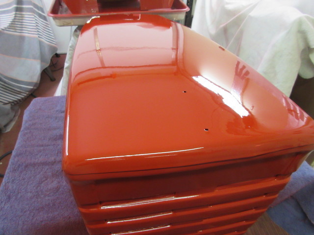

Zeek 2,299 #1 Posted March 10, 2016 Wow, it was in the 70's here in south central PA which is almost a record for us Sooo, I figured a good day to bang off a half day of work and paint some parts! 27 Share this post Link to post Share on other sites

elcamino/wheelhorse 9,363 #6 Posted March 10, 2016 Did you use raddle cans? That is one very nice paint job. Share this post Link to post Share on other sites

Tankman 3,528 #10 Posted March 10, 2016 Excellent painting! Rattle cans? Paint color and manufacturer? Had nothing ready to paint but, if I did yesterday would've been a good day. Share this post Link to post Share on other sites

Zeek 2,299 #12 Posted March 10, 2016 12 hours ago, elcamino/wheelhorse said: Did you use raddle cans? That is one very nice paint job. No, on the big parts I use a HF gun. You can thin the paint a little more for better flow out. 7 hours ago, Phatboy said: Wow buddy we are neighbors !!! I live in johnstown !! We will have to meet someday for coffee !!! See you at the show hopefully! 4 hours ago, Tankman said: Excellent painting! Rattle cans? Paint color and manufacturer? Had nothing ready to paint but, if I did yesterday would've been a good day. HF gun, good old Rustoleum Regal Red thinned with acetone. I use a regulator at the gun with an inline desiccant dryer before that to keep out oil/water. I have a water separator on the wall outlet, but I don't completely trust it. Wipe down with a tack cloth before starting. 2 Share this post Link to post Share on other sites

WHX?? 55,753 #14 Posted March 10, 2016 Man wish I could paint like that! Almost looks like you have a clearcoat on it?? 1 Share this post Link to post Share on other sites

TDF5G 2,073 #17 Posted March 10, 2016 Paint job looks great! It takes a lot good preparation doesn't it? Share this post Link to post Share on other sites
squonk 45,828 #18 Posted March 10, 2016 You have a red floor just like me! Best way to keep out the moisture is plumb your air with metal lines to give the air a chance to cool and condense the water so the traps can stop it. Heated air in the tank expands as it leaves releasing some moisture. That's the stuff that causes the issue. Cooling it (or trying to cool it below dewpoint will get it all out. I paint with an HVLP electric turbine. The turbine warms the air and evaporates the moisture before it gets to the gun. Share this post Link to post Share on other sites
Zeek 2,299 #19 Posted March 11, 2016 (edited) The air comes about 30' by hardline across the garage from the other side, but mine still gets a little damp if you run the compressor hard. So tonight I carefully unmask the undersides and then manage to drop the damn fender pan on the floor I think the marks will wet sand/buff out after it dries for a while Edited March 11, 2016 by Zeek Share this post Link to post Share on other sites
