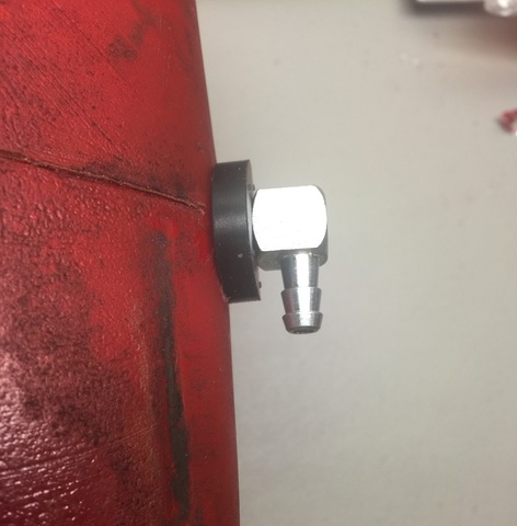

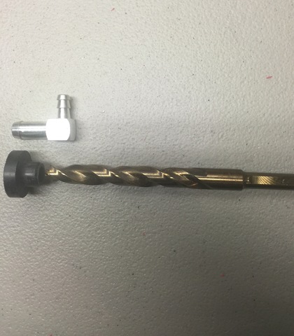

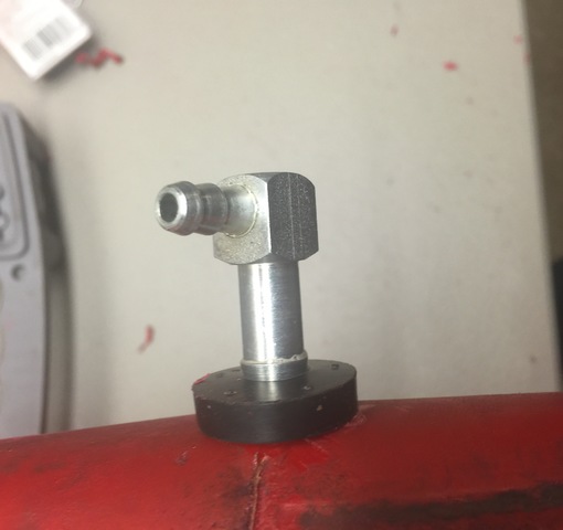

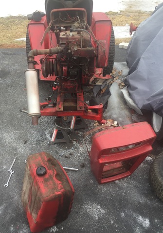

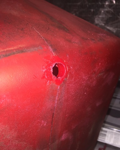

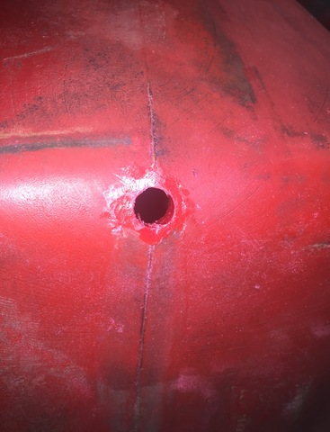

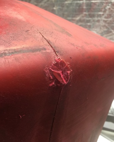

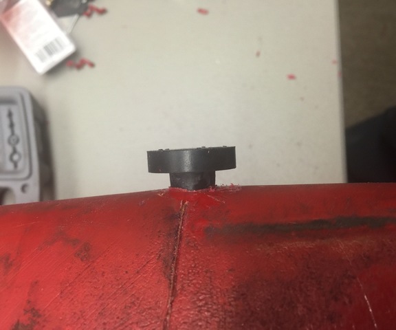

Aldon 4,826 #1 Posted March 6, 2016 I really need the weather to start turning as I can't seem to wait any longer to work on tractors. So I braved the cold today and decided to tackle the tank repair on my back up GT14. I plan on posting it on classifieds once I have her back together and ship shape. While the repair itself is easy, it is a royal pain to get tank out to do the modification. First the incision... Then cut the offending leaking cracked nipple off. The tanks are molded together and the seam is through center of the nipple. This is a weak point on this design and very often it fails. cut it flush. I used a dremel blade to make the cut and a dremel metal removing bit to contour the remaining surface. Then using drill bit that is the same diameter as the grommet I enlarge the hole. note that there is substantial tank thickness to accept the force fit that comes at the end. insert the grommet. In pic it's not fully inserted yet. Push in in until flush. Then the fun starts. The leak proof seal is cause by pressure of the grommet to the sides of the tank when you insert the steel fitting. It's easy to start but can be a bit of a wrestling match to get it inserted fully. It will go in though. Part numbers can be found on my GT14 restomod thread as I documented there for that restoration. 8 1 Share this post Link to post Share on other sites

Aldon 4,826 #3 Posted March 6, 2016 Yes. This is my second tank repair. However I will go ahead and do the same mod on my most recent acquisition as well as soon as I get the parts. I can't stand leaking tractors. 2 Share this post Link to post Share on other sites

Aldon 4,826 #7 Posted March 7, 2016 1 hour ago, Pollack Pete said: Aldon,I have 4 or 5 GT-14's.While I haven't had any leaky gas tank issues yet,I have had the gas tanks out of all of them ,usually for carb work and fuel hose replacement.How do you like the weight of that monster grill? Almost need a chain hoist to lift it.And how about getting the bottom bolts back in when re-installing the grill? Love those GT-14's though.I like your nipple repair.Good old yankee ingenuity. Pete, Sounds like you've had good luck acquiring units that were not defective. Once the tractors are in the hands of someone who is skilled at maintenance and they are operated with some care, it is doubtful the tanks will spontaneously break. The two issues that result in the failure are over tightening of the hose clamps on the nipple and physical impact as it is in a less than ideal location. I have some gas line tubing that maintains flexibility in low temps which allows a good deal to the nipple without excessive force. I may use this on my GT14#3 and keep it original if the nipple is in good shape. And your observations are correct in regards to weight and lining up the base. Pain in the ...... PITA:-) Share this post Link to post Share on other sites
