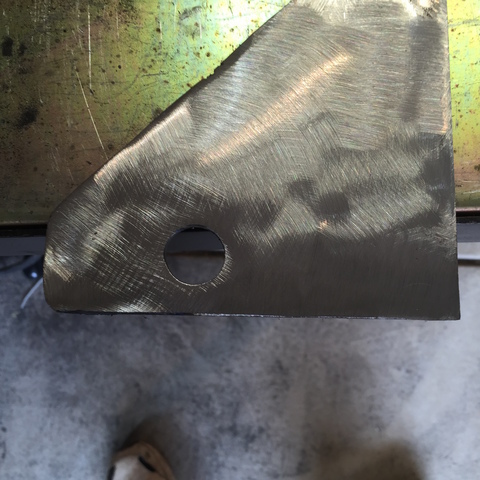

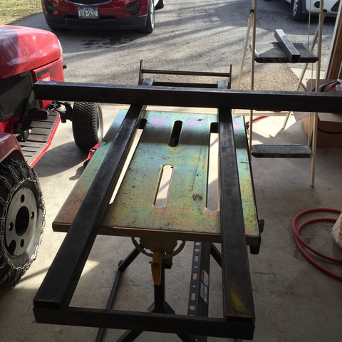

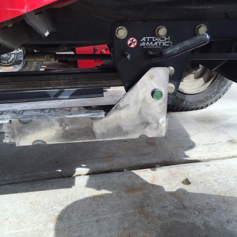

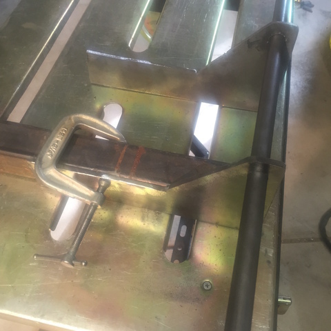

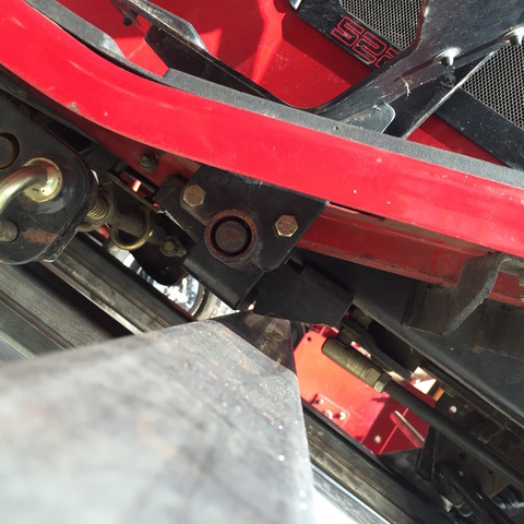

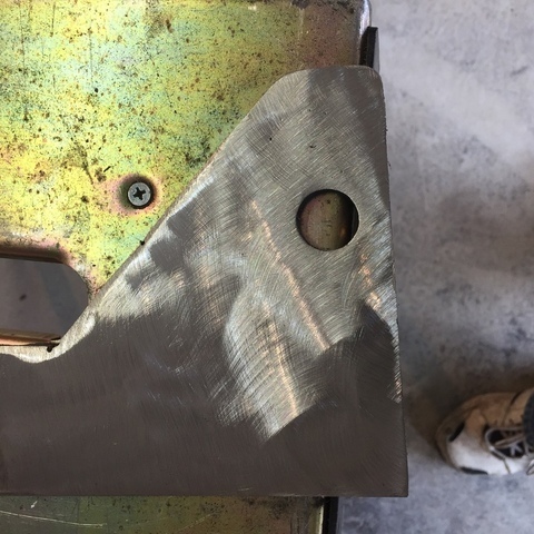

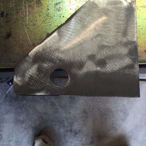

WNYPCRepair 1,923 #22 Posted March 6, 2016 (edited) 4 hours ago, Snowmobileaddict said: Do the PF plans suggest using (4) identical cylinders? Or slightly longer ones for the boom versus the bucket? They show 4 identical cylinders. I had considered the same thing, that I didn't need the same length or the same stroke, but I finally just ordered 4 of the same. I had to move the mounting holes at the mid attach point down about an inch and a half, and fill in the old ones. I was sloping down from back to front about 1 1/4" in 4 feet. I am still sloping down about 3/8", but I don't suppose it is that critical. Didn't turn out too bad considering my limited welding experience. Then I mounted it to check fit, and saw that I have a tight fit between the cross support for the pedestals and the motion control pedal bracket. I have the cross support back at 11 1/2" (instead of the 12 3/4 in Andy's subframe drawing) and only clear by about 1/4". Sorry the picture is a bit crooked, I was laying on the floor, couldn't get a good angle. The mid mount, clipped into the mid tach-o-matic A shot of the subframe with the 3/4 round stock cut to length and welded in I have a piece of angle iron tacked front and back to keep it square until I weld it all up. What are the chances that I would just happen to have two pieces of angle iron the exact length I needed just laying around? I was shocked. Everything is just tacked at this point, except the round stock. The rear axle mount. Mine stick farther out the back than Andy's, I have plans for those ends which I'll get into later. Oh, and the 2" x 2" square stock is only 1/8" thick, not 1/4" like I thought. I would have liked to use 3/16" at least for those, but I used what I had on hand. If I think it is going to be a weak point, I can always add a length of 1 1/2" angle iron on each side to stiffen it up. Now unfortunately, I am at a stopping point. I need the U Bolts for the rear, and the steel for the pedestals. Edited March 6, 2016 by WNYPCRepair 3 Share this post Link to post Share on other sites

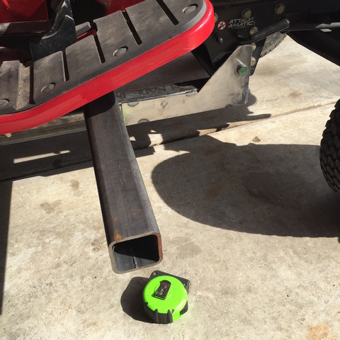

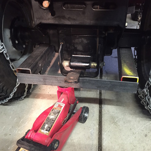

Snowmobileaddict 403 #23 Posted March 6, 2016 Extra long subframe rails.... Quick release suitcase weight bracket or other counterweight solution? Lookin good! 2 Share this post Link to post Share on other sites
WNYPCRepair 1,923 #24 Posted March 7, 2016 (edited) 2 hours ago, Snowmobileaddict said: Extra long subframe rails.... Quick release suitcase weight bracket or other counterweight solution? Lookin good! You nailed it, but it will be able to do more than just weights. Trailer hitch, for one. Maybe even a 3 point hitch, though I really have no need for one, so I may not bother. I think to start I am just going to make a platform for cement blocks, since I have the blocks already. Edited March 7, 2016 by WNYPCRepair Share this post Link to post Share on other sites
DennisThornton 4,771 #25 Posted March 7, 2016 Holy cow Brian! Slow down! I said I'd have time to watch but geese! And you filled in those holes just fine for a newbie! I'd want confirmation but I'm thinking that 1/8" box tubing is pretty darned stout for what you are doing underneath. 1 Share this post Link to post Share on other sites
