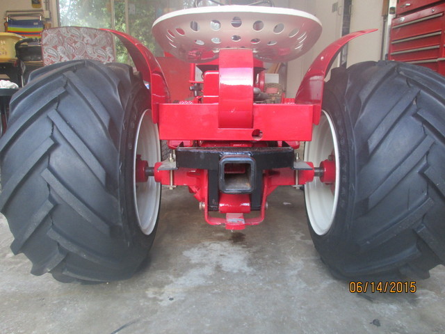

clip 185 #2 Posted March 5, 2016 My Tru Powers mounted on stock/7" wide (IIRC) wheels. Exact size you're thinking of running and they work and fit perfect. Good flat tread profile. Replaced 23x9.50 turfs, however I'm thinking of picking up a second set of wheels to keep the turfs mounted as well. I mounted mine with tubes as the fronts needed tubes and it was some cheap insurance against leaks for the rears. 8 Share this post Link to post Share on other sites

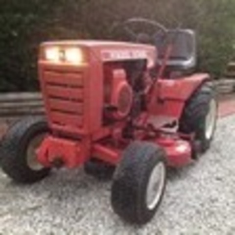

can whlvr 994 #3 Posted March 5, 2016 those look nice 1 Share this post Link to post Share on other sites
Retired Sparky 526 #4 Posted March 5, 2016 13 hours ago, can whlvr said: those look nice Those are nice Brother. 2 Share this post Link to post Share on other sites
joecimadon 2 #5 Posted March 5, 2016 19 hours ago, clip said: My Tru Powers mounted on stock/7" wide (IIRC) wheels. Exact size you're thinking of running and they work and fit perfect. Good flat tread profile. Replaced 23x9.50 turfs, however I'm thinking of picking up a second set of wheels to keep the turfs mounted as well. I mounted mine with tubes as the fronts needed tubes and it was some cheap insurance against leaks for the rears. Those look great! I'll have to purchase now! I'll post some pics once they're on! Thanks for your help -Joe 1 Share this post Link to post Share on other sites

clip 185 #7 Posted March 6, 2016 (edited) They're 23x8.50. I could have gone with 10.50s but didn't for a few reasons. My wheels weren't wide enough to meet Carlisle's recommendedations, and losing an inch or so of wheel would have made the tread profile go from relatively flat as intended to somewhat rounded. In addition, it's my opinion that ag/bar/lug tires work as intended when they don't provide as much floatation. Seems like most farm tractors are sporting taller, narrow tires for ground engaging work to cut through the loose soil and bite into some harder ground to get traction (similar to snow tires on rally cars). So going with 8.50s seemed like a good idea. If I want floatation to minimize turf impact I'll switch back to my 9.50 Turf Savers and probably lose the wheel weights, as this yard is very flat compared to where I have been mowing. I'll keep the ags for dozing, tilling, plowing, etc. Now I just need to get a tiller setup and I'll be golden. And maybe a few more WHs. Only downside so far has been using them in winter with 14" of snow, but 2-link chains got me through. I do think the Turfs would have performed just as well, maybe a little better as they would have pushed more chain into the ground. Edited March 6, 2016 by clip 2 Share this post Link to post Share on other sites

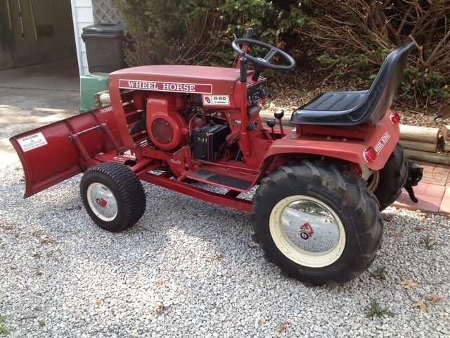

TDF5G 2,073 #10 Posted March 7, 2016 The 23X8.50s will fit very nice on your stock wheels. Here is a pic of Carlisle AGs on my 1977 B-80. 1 Share this post Link to post Share on other sites
857 horse 2,588 #11 Posted March 7, 2016 These are 23x10.50x12 on 10 inch rims.....tubes.....no leaks,,,,no slip......lotta bite.........but no Kung Foo grip !!!!!! 1 Share this post Link to post Share on other sites
