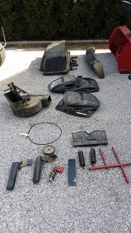

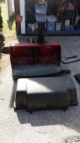

cafoose 3,853 #1 Posted March 3, 2016 (edited) My birthday is next week and I bought myself a new toy for $800 a 1988 520-HC. I downloaded all the manuals for it but I can't find the snow thrower operating manual. I have the parts manual for the snow thrower. I'm not sure how to attach the snow thrower either. Tractor model C120OE01 serial 10319, deck model 054SMS05, Snow Thrower Ber-Vac W 046 D Edited March 3, 2016 by cafoose add text 7 1 Share this post Link to post Share on other sites

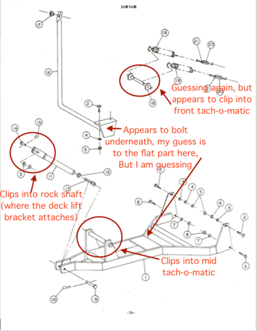

953 nut 69,454 #2 Posted March 3, 2016 You really know how to celebrate your birthday. The good news is that you should have about eight or nine months to figure out how the snow blower hooks up. I don't have a snow blower, but looking at your it appears that it would use the mid-mount atach-amatic where the mower is presently attached. Others who know will chime in soon. Share this post Link to post Share on other sites

gwest_ca-(File Mod) 12,489 #6 Posted March 3, 2016 Perhaps this manual will help Garry 2 Share this post Link to post Share on other sites
cafoose 3,853 #7 Posted March 3, 2016 1 hour ago, gwest_ca said: Perhaps this manual will help Garry That's the manual I downloaded and it only shows parts I would like instructions and pictures how to attach everything to the tractor. Share this post Link to post Share on other sites

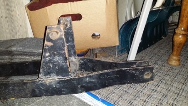

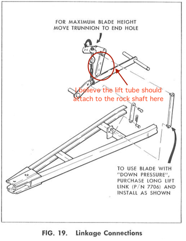

WNYPCRepair 1,924 #8 Posted March 3, 2016 5 minutes ago, cafoose said: That's the manual I downloaded and it only shows parts I would like instructions and pictures how to attach everything to the tractor. Can you get a closeup of the two circled parts and post it? Share this post Link to post Share on other sites
cafoose 3,853 #9 Posted March 3, 2016 29 minutes ago, WNYPCRepair said: Can you get a closeup of the two circled parts and post it? What two circled parts are you referring to? Share this post Link to post Share on other sites
gwest_ca-(File Mod) 12,489 #10 Posted March 3, 2016 Try this one. On page 14 it shows the frame that appears to mount in the mid hitch and a link to the tractor lift. There are 2 lift assist springs that hook into the front hitch. Garry Share this post Link to post Share on other sites
cafoose 3,853 #11 Posted March 3, 2016 11 minutes ago, gwest_ca said: Try this one. On page 14 it shows the frame that appears to mount in the mid hitch and a link to the tractor lift. There are 2 lift assist springs that hook into the front hitch. Garry That does show me more but I would also like to see a little more detail on how it actually attaches to the tractor like on the lift lever and both ends of the assist springs and things like that. Share this post Link to post Share on other sites
WNYPCRepair 1,924 #12 Posted March 3, 2016 48 minutes ago, cafoose said: What two circled parts are you referring to? Oops, forgot to attach the picture, LOL Share this post Link to post Share on other sites
cafoose 3,853 #14 Posted March 3, 2016 13 minutes ago, WNYPCRepair said: Oops, forgot to attach the picture, LOL 11 minutes ago, WNYPCRepair said: Share this post Link to post Share on other sites
Ed Kennell 47,396 #16 Posted March 3, 2016 I think you nailed it Brian, and I'm guessing the middle or top hole to get enough leverage to lift that monster blower that's hanging so far in front of the pivot point. 2 Share this post Link to post Share on other sites
