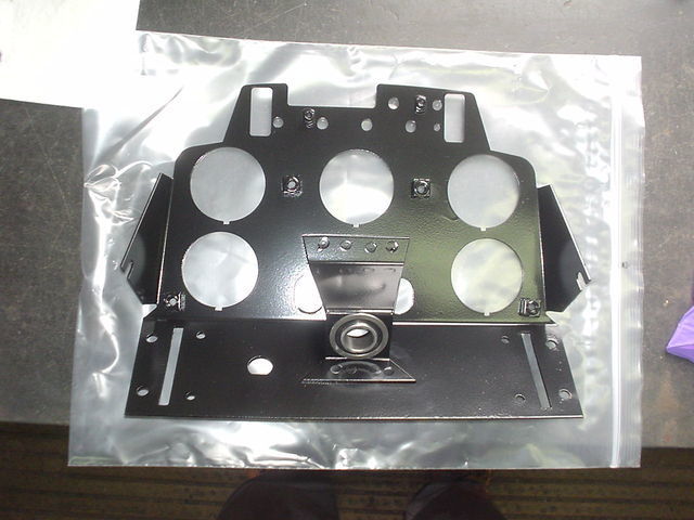

skrusins 128 #1 Posted March 1, 2016 In upper shaft the console is egg shape in which the bearing sets in. I did do a search and the only thing I was able to find were someone bolted a flange bearing part no,6472. I would like to do more research on this. Can someone direct me to get more ideas. Thanks you Guys are Great! 1 Share this post Link to post Share on other sites
cleat 8,735 #2 Posted March 2, 2016 (edited) I drilled out the hole where the original bushing sat and installed a flange bearing the same as most Wheel Horse front wheels use. This is on a 520 but yours may be able to have this done as well. These are readily available, just get one with the right size center for your steering shaft (mine is 3/4"). Eliminated all the side to side play and because it is a ball bearing, steering effort is also slightly reduced. Edited March 2, 2016 by cleat 2 Share this post Link to post Share on other sites

skrusins 128 #6 Posted March 2, 2016 Thank You so much to all of you for your fix. I'll definitely use the one that will work the best for me. Once again Thanks again, also the pics were great. Share this post Link to post Share on other sites
