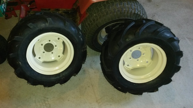

Last summer I installed 23 x 10.50-12 Deestone ags on stock C-series rims, I knew they'd bulge out so I raised the fender pan an inch and 1.5" wheel spacers to match the front track of a swept forward axle.  It is very easy to raise the fender pan...  plasma cutting seems like a lot of unnecessary, extra work!
20151210_182158_resized.jpg.ad406f0279e7
