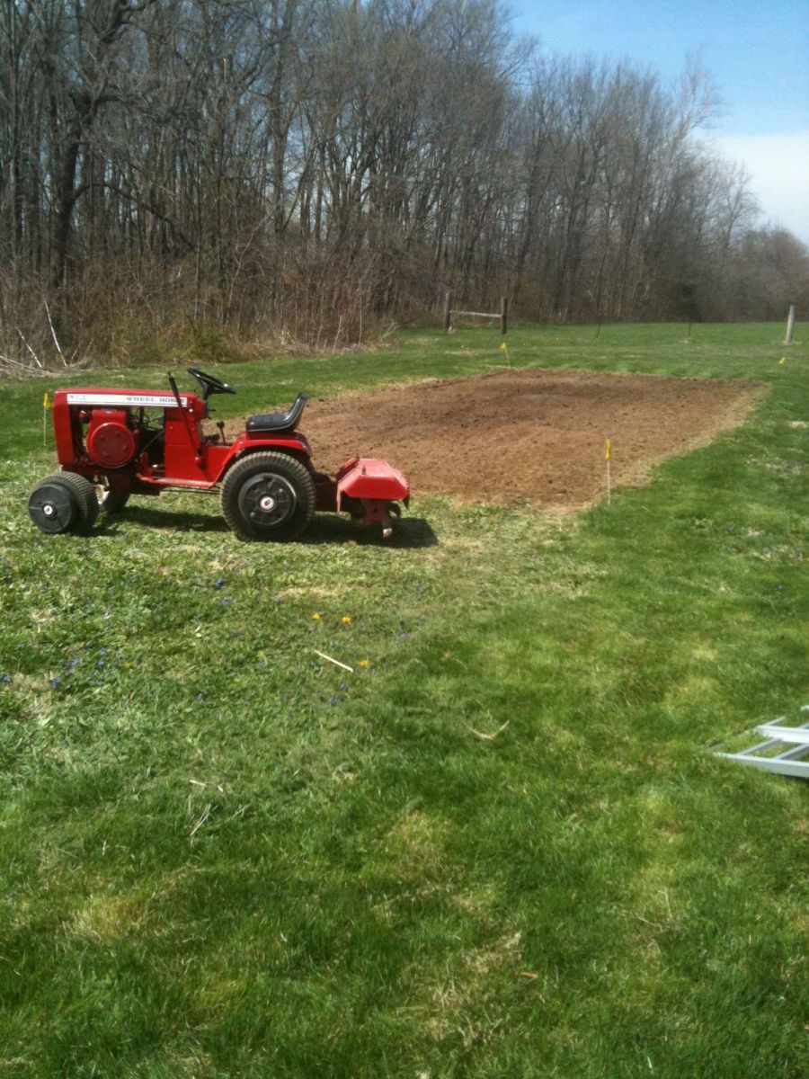

I have been using one the last two years.   I put it on my 1979 Wheel Horse C-121  -8 Speed.    My tiller is an early 1990's model I bought from a Professor in  a nearby town.   The tines had one side wrapped in nylon clothes line  and some wire which needed to be removed.    I used two years ago in my garden  (60 x 100).  Last year I had to change the oil seals on the one side that the nylon clothes line had run around as I noticed a small leak of gear oil from the case.  All and all I would say the Wheel Horse tiller attachment surprised my how well it worked.
I had the  extra lift assist spring installed as the tillers heavy on the back of a tractor.   A hydro lift on a tractor would make it easier to use.  One of the things I found interesting is that  with such a long belt to turn the tiller the belt would often jump off if you shut the tiller off using the PTO.   I found I could lift the tiller when finishing a row of work and turning the tractor that I could keep the tiller PTO engaged and turning the tines and not jump the belt off.
Here is my setup with my friend Steve operating the tractor.
gallery_339_343_281108.jpg238.thumb.JPG.c6d4e4570c20582777eed48a8d
THIS IS A LINK TO THE TILLER IN ACTION VIDEO:

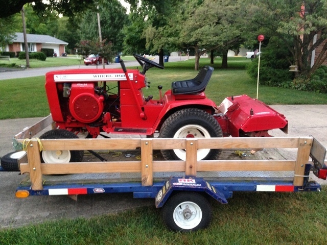

yes chad your 314-h will work just fine(as already stated by other s)don't let my statement shy you from putting one on your hydro,if you have never tilled with a gear tractor you probally wouldn't know what we are talking about anyway,mine on my 312-h certainly worked,it just gets pushed along here and there,and yes a few more passes is required but the good is you get more seat time,and tilling is quite enjoyable,at least for me,and the hydro lift is a bonus,heres my 1975 36 inch tiller,its in nice shape so im sure you will find a nice one
