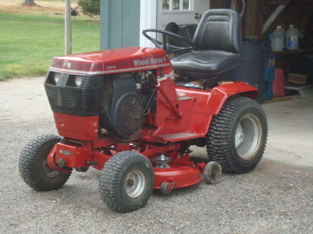

JAinVA 4,638 #2 Posted February 27, 2016 Not a problem.I just mounted a set of 16x6.5x8 tires yesterday on my 310-8 in place of the stock 6 inch tires.It seems to be the most popular upgrade for the 300 series.Getting the rims seems to be the biggest challange,since everyone wants them. Luck,JAinVA Share this post Link to post Share on other sites

pfrederi 19,936 #5 Posted February 27, 2016 (edited) Most of the 300s had 6" front wheel and the spindles were longer to make up for the small wheel and keep the tractor level. If you put 8" wheel you will raise the front of the tractor an inch. i like Cn whlvr replaced spindles when I went o 8" (They ride better on the rough ground I have..also went to bigger rears)...but since she isn't on mower duty I doubt i needed to. Edited February 27, 2016 by pfrederi Share this post Link to post Share on other sites
953 nut 64,221 #6 Posted February 27, 2016 The 8" rims and tires from the older will fit right on, I had to put a couple of washers behind them to make up the length of the spindle. You will have to adjust the mower to make it be level, but otherwise no problem. 1 Share this post Link to post Share on other sites

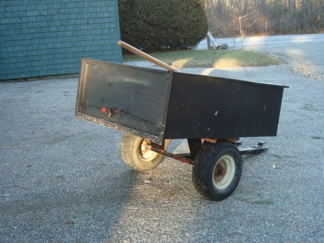

Retired Sparky 526 #7 Posted February 27, 2016 5 hours ago, JAinVA said: Not a problem.I just mounted a set of 16x6.5x8 tires yesterday on my 310-8 in place of the stock 6 inch tires.It seems to be the most popular upgrade for the 300 series.Getting the rims seems to be the biggest challange,since everyone wants them. Luck,JAinVA I've got 16-6.50x8'' on my trailer. Why can't I just swap them out?? I've also got a 310-8. Share this post Link to post Share on other sites
JAinVA 4,638 #8 Posted February 28, 2016 They should work if the cart axle is 3/4".From the pictures of the cart it looks as if the wheel is centered on the hub.No offset.If that is the case you could use washers as spacers to get the proper offset.As pointed out by others 16" tires will raise the front of the 300 series.Kinda looks like the gasser dragster of the sixties.JAinVA 1 Share this post Link to post Share on other sites
