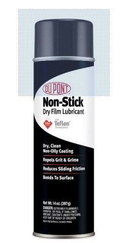

Aldon 4,828 #10 Posted February 22, 2016 Any Dry Lubricant would work I would think. I used to use Liquid wrench Teflon spray for internals on fire arms. Here is a pic of another brand that would essentially lub but not attract and cause issues. 2 Share this post Link to post Share on other sites

Phatboy 565 #13 Posted February 23, 2016 I went looking for graphite today and saw that liquid wrench dry lube,, didnt get it cause i never saw it before,, wasnt sure if it was any good or not,,i guess im gonna have to get a can and give it a whip.. Share this post Link to post Share on other sites
