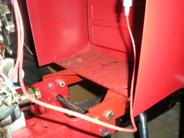

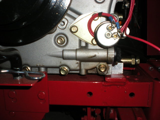

shallowwatersailor 3,220 #8 Posted February 22, 2016 My conversion, done by Joe Mazur, is on a Blackhood C-85. I think that the square, tall shape of the hood makes fitting the engine in easier. The only changes were to raise and extend the hood hinge, replace the shaker plate with steel strips, and make the exhaust into a vertical stack. If it was to be used year round, like most small engines today there are two oil drains. One could be possibly converted to an immersion heater. I did add an extension on the one I drain the oil that originally came from a generator application. The black cap in the bottom photo below the starter is the oil strainer. Obviously engineered better than the Honda clone engines, although this is supposedly a Yanmar clone! Share this post Link to post Share on other sites
