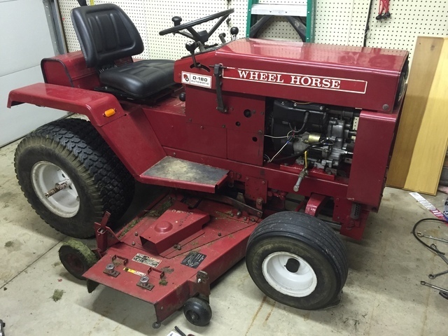

tommyg 157 #5 Posted February 26, 2016 I've done it. Mounted the 60" deck under my D180. Absolutely love it. I found a hanger for the D, then mounted it on the deck. Had to extend and angle the arms slightly so I could mount the deck back far enough to clear the front wheels. But really, the hardest part was finding a belt to fit. I may have some pics I can send, but I've got the blower on right now. 1 Share this post Link to post Share on other sites

tommyg 157 #8 Posted February 26, 2016 2 hours ago, new2horses said: So if I understand correctly the hanger brackets used on the "D" would be different than those for the 5XX machine. That is correct. You'll need a D hanger. I modified the length of both arms so that they lined up with the existing rear supports on the deck. It's not a 60" deck from the XI series is it? I looked at that options once and it was not going to work. I'm going to try and up load a pic for you but for some reason it's not letting me do that in this post. Stay tuned. Share this post Link to post Share on other sites
tommyg 157 #9 Posted February 26, 2016 Here's a look. You can't see the modification to the support arm, but I can probably get you a better pic if you need one. 2 Share this post Link to post Share on other sites
