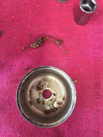

WNYPCRepair 1,924 #10 Posted February 18, 2016 This is what was in the carb in my brother in law's Deere after sitting for a year or two. It was packed around the float. There was more, this is just what I caught, the rest fell on the floor. I had the exact same symptoms. 1 Share this post Link to post Share on other sites

WNYPCRepair 1,924 #12 Posted February 18, 2016 clean the carb Share this post Link to post Share on other sites

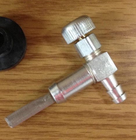

Aldon 4,832 #13 Posted February 18, 2016 Something you did improved things. So your on the right track. May be jets. I ran into similar problem and thought I had resolved by replacing the fuel lines. It ended up the screen filter inside the fuel cock was clogged. If you have one of these, it is worth investigating if it is partially clogged. Share this post Link to post Share on other sites
