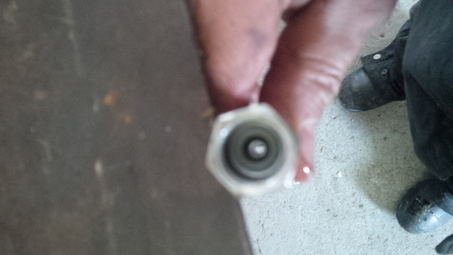

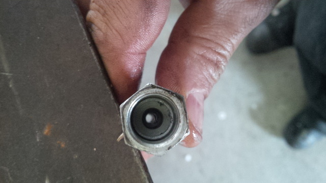

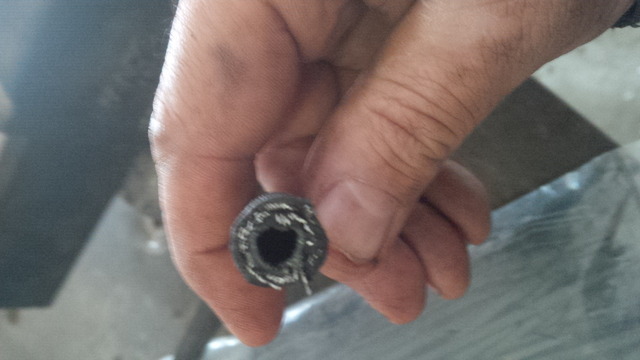

T-BONE 1 #11 Posted February 15, 2016 I took the line of that was made and couldn't blow through it. The outside line of the filter that goes to transmission under the seat. I took the entire hose off and then could blow through it but it was hard. Here are some pics. What size is the original hard pipe. Share this post Link to post Share on other sites
cleat 7,228 #12 Posted February 15, 2016 I am in the house right now but I think the original is a 3/8" tube. Should be pretty easy to blow through. I can quite easily blow through the 1/4" fuel line from the tank to the fuel pump. Any restriction in that line could cause all sorts of issues with the filter. Share this post Link to post Share on other sites
T-BONE 1 #13 Posted February 15, 2016 I'll get on made a 3/8 made up tommorw. Share this post Link to post Share on other sites
