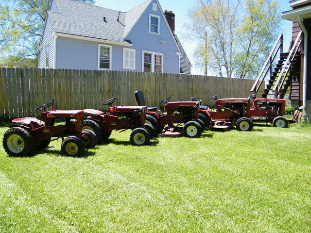

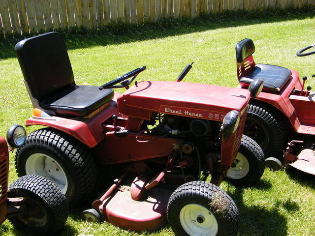

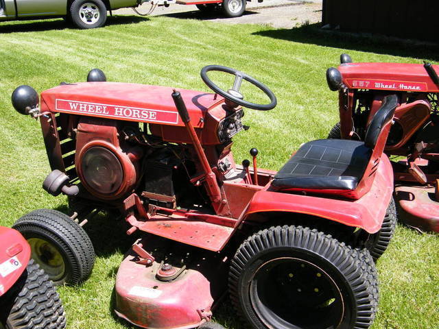

857 horse 2,588 #17 Posted February 15, 2016 On 2/14/2016 at 1:10 PM, slammer302 said: My commando 8 was gave to me by my dad and was my first horse. Sounds like we have the same story stevasaurus Well folks you heard it here first,,,,you wanna round the block and bring home the bacon and the babes......Gimme a call,,,,we will work everyone into the schedule... On a serious note.......something I rarley do.... we will have a spring 857 line-up,,,, all running... snap a few shots of the happy almost 1/2 dozen 857's..... with the Titantic Suburban In the meantime, we pushed 1/2 a foot today,,,,,,,,,,,,,, 1 Share this post Link to post Share on other sites

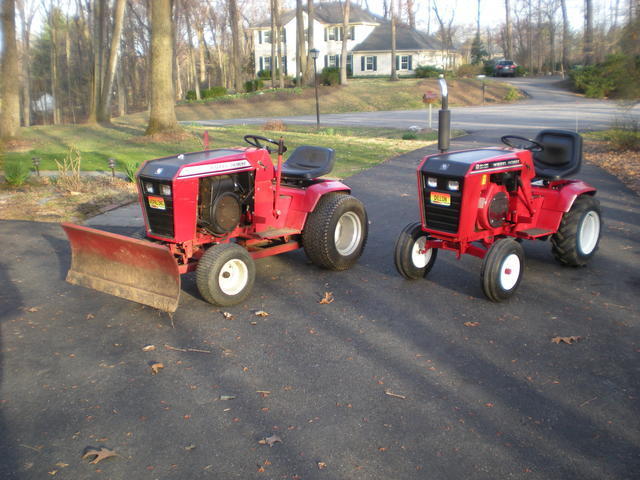

rjg854 12,856 #23 Posted February 16, 2016 Well my Commando 8 didn't do too bad this morning with this soaking wet snow we have, altho I see a strong need for chains! I filled the tires with RV antifreeze, and I only weigh in at about 160 lbs. She just wouldn't push long distances with all that weight in front of the plow, but as long as I could take small bites it pushed fine. With just the turfs, it would lose traction. Chains I'm sure would have given me more bite. This is my first year having a for snow duty, so it's also a learning process for me. I'm really impressed though on just how well it does it's job. The other day when it was 20 below it started as tho it was 70 degrees. This morning we have steady rain and about 4" of snow but it is nothing but slush. Do I understand this is a short frame tractor? It's really maneuverable I got everything plowed out around the barn and the shed, and the house, which is basically a big circle. The 1/4 mile drive I drove down with the truck to open that up, I try the after I dry out to clean it up some more. Maybe by then it will melt out and make plowing easier. I could leave it but when it freezes again later, it will really be tough to plow. There was no way the blower on the other Commando was gonna deal with that slush. I did get to use it last night when I got home to clear a big drift and it worked great. I wish I had gotten into Wheel Horse years ago. 2 Share this post Link to post Share on other sites
