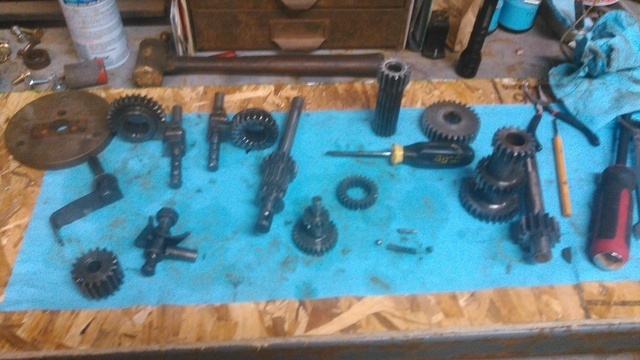

stevasaurus 23,808 #26 Posted March 25, 2016 That is your reverse idler...racinfool40 should have one of those if you want to replace it. Those detente balls are a riot, aren't they? I'm thinking I would replace it, as long as you have it open. That gear never stops turning as long as your input shaft is turning. It is always 1/2 engaged with the cluster gear and the other half with the fork gear when you shift into reverse. Share this post Link to post Share on other sites

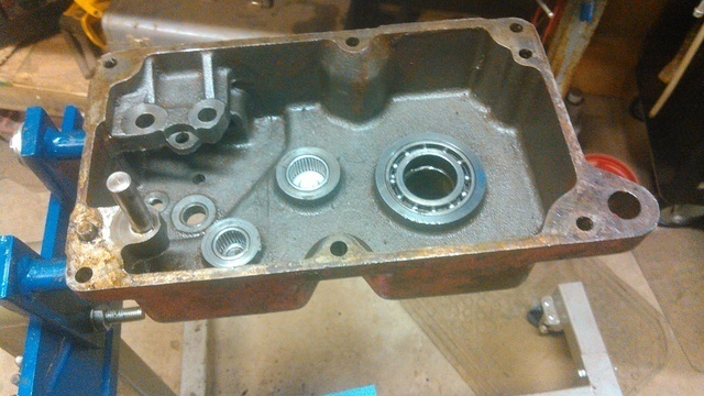

grine_22 145 #32 Posted March 26, 2016 It seems like no matter how often I organize the garage is still a mess. But a question for the more knowledgeable, what threaded plug does it take for the hole in the detent passage, mine never had a plug and I want to fix it. Share this post Link to post Share on other sites
stevasaurus 23,808 #33 Posted March 26, 2016 It is a 1/4" hole. It is not threaded. Just take a finger of grease or silicone calk and put in the hole...it will not leak. It is tight up against the mounting plate. Share this post Link to post Share on other sites
grine_22 145 #34 Posted March 26, 2016 Does it work as vent or weep hole, I was thinking about tapping it and putting a small plug in it Share this post Link to post Share on other sites
Racinbob 13,113 #35 Posted March 26, 2016 No, it doesn't act as a vent but I don't see a need to tap and plug it. As Steve said, it's completely covered when the transmission is mounted. You might end up with a plug that won't come out if you ever have to service it again. Share this post Link to post Share on other sites
stevasaurus 23,808 #36 Posted March 26, 2016 That hole's soul purpose in life is just to be able to put the detente balls, spring and stop in the transmission. If you put something in there that is not flush with the outside, your trans will not mount right against the frame plate. I have a 702 transmission that I did nothing with that hole and it does not leak. Either grease or calk or nothing. Share this post Link to post Share on other sites
grine_22 145 #37 Posted March 26, 2016 Roger that, I'll just grease it up. the hole where the shift rail slides in that you need to drop the detent ball in, I thought of putting grease in it to help hold the ball in place until I can get the rail in, might try that out next time I go to work on it. 1 Share this post Link to post Share on other sites
grine_22 145 #38 Posted March 29, 2016 Got my detent ball back in finally, but I'll probably pull it all back part and clen it 1 more time, the reverse idler gear, does the beveled side go up or down when putting it back together? Share this post Link to post Share on other sites
stevasaurus 23,808 #39 Posted March 29, 2016 The flanged end of the idler gear goes down. Share this post Link to post Share on other sites

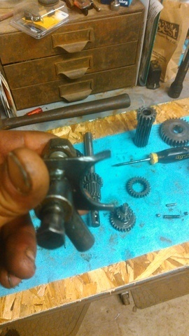

grine_22 145 #40 Posted March 31, 2016 So I've got it all apart for the 2nd time, I don't like the way my hi/low rail looks being run a lil rough. Any ideas or am I gonna need to just find a new one? Share this post Link to post Share on other sites
stevasaurus 23,808 #41 Posted March 31, 2016 It is hard to tell from the picture how bad it is. If you want to change it...PM Racinfool40. 1 Share this post Link to post Share on other sites
grine_22 145 #42 Posted March 31, 2016 On the top rail of the fork its starting to get worn thin on each edge, I've found it online and beins I needed a gasket I ordered the fork assembly as well. 2 Share this post Link to post Share on other sites
