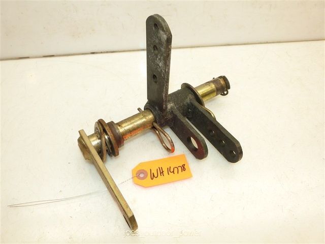

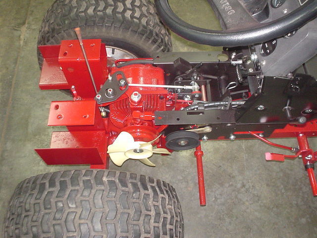

cleat 7,233 #14 Posted February 13, 2016 (edited) The other thing I did was to add a later style rockshaft with the extra arm that the trunnion passes through and gets supported on both sides. This is much stronger than the usual way. This is a sample picture as I don't have pictures of mine. You can just make it out in this picture of my 520-HC. Edited February 13, 2016 by cleat 1 Share this post Link to post Share on other sites
