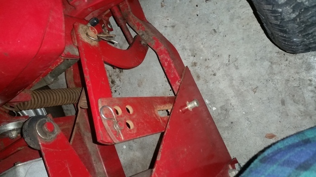

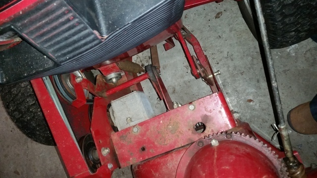

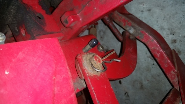

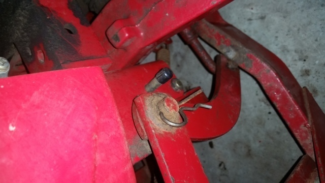

justb218888 0 #1 Posted February 8, 2016 Hey guys, long time follower here and wheel horse crazy :). I have an issue with my 2 stage snowblower on my 520-h. When I lower the blower and make a pass on the driveway I get to the other end and it won't lift. When I get off the tractor to inspect. I find that where the lift tube meets the rotating steel piece on the blower is jammed against the frame of thw blower. I have to push the blower the opposite way and hit the steel piece and lift tube with a hammer. I've even went back to my manual and it loops like I got everything together the right way. I've used this for the last 7 years and never had an issue till now. Only thing I don't have is the lift assist spring under the tractor. Any ideas here as to what might be going on? Thank you. Share this post Link to post Share on other sites

MalMac 1,333 #4 Posted February 9, 2016 There was a service bulletin on this. The part the lift rod goes into needs to be bent inward about 1/4 inch to avoid interference with the blower frame. I had it start hitting on mine bad enough that it would knock the hair pin out and drop the lift rod. Share this post Link to post Share on other sites
justb218888 0 #5 Posted February 9, 2016 Here is some pics. When you bent yours what did you use? That looks like some pretty heavy stock steel? We are talking about the angled piece that moves right? Share this post Link to post Share on other sites
MalMac 1,333 #6 Posted February 9, 2016 The piece that is curved that the lift rod attaches to. If I remember right you come up from the bottom of it 2 inches. Probably have to heat it then bend bottom inward. Bend stright across parallel with the ground. Share this post Link to post Share on other sites

justb218888 0 #9 Posted February 9, 2016 Thanks guys really appreciate it. I will try and attempt this. I love my 2 stage. Went through 3ft of snow 2 weeks ago. Wouldn't trade ever for a single, if I can get this operating satisfactory. Thank you Share this post Link to post Share on other sites
