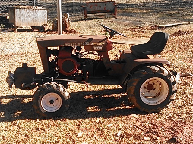

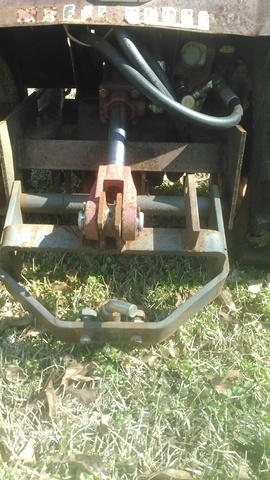

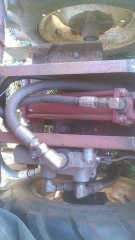

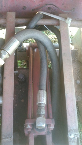

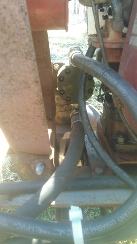

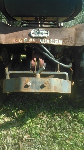

JPWH 6,365 #1 Posted February 7, 2016 This is a hydraulic lift I started in 1999 I bought all the parts and due to working out of town never started it. Last year I had to move tons of dirt from installing a pool so I built it to do that work. I have found the cylinders and control valves I want and will be building a hydraulic system for the 854 as well as rebuilding the system for the Raider 12. The square tank on the front will be replaced with a schedule 40 pipe bumper/ tank. 4 Share this post Link to post Share on other sites
elcamino/wheelhorse 9,362 #2 Posted February 7, 2016 I really like the set up looks like a factory option . Everything is tucked away , Very good work 1 Share this post Link to post Share on other sites
elcamino/wheelhorse 9,362 #3 Posted February 8, 2016 Hank one question where is the tank for the hydraulic fluid ? Share this post Link to post Share on other sites
JPWH 6,365 #4 Posted February 8, 2016 (edited) 9 hours ago, elcamino/wheelhorse said: Hank one question where is the tank for the hydraulic fluid ? Mounted on the front. 9x9x9 tank. That is what is going to be replaced with a pipe bumper. Edited February 8, 2016 by Hank01 Share this post Link to post Share on other sites
elcamino/wheelhorse 9,362 #5 Posted February 8, 2016 Thanks , I would love to that but clueless on Hydraulics . Would not know where to start . Please keep us informed when you start you project. Share this post Link to post Share on other sites
