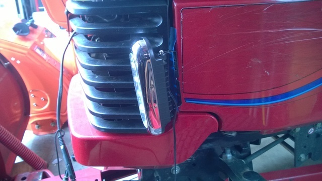

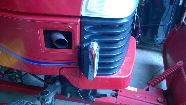

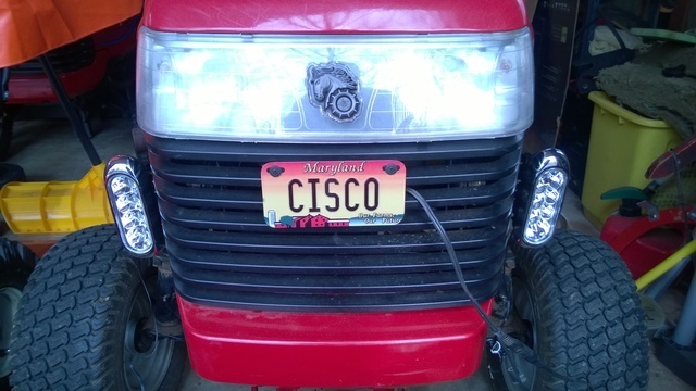

shallowwatersailor 3,214 #16 Posted February 7, 2016 Spent some time in the garage this afternoon putting the suitcase weights back on "Cisco." I realized I had the inexpensive LED lights from Advance Auto on the shelf. They are only taped in place but look pretty good on the 5xi. There would be two different mounting points available. One would be to the edge of the removable side panels; or mounting them to the hood support upright. The only obstacle is the exhaust discharge so mount it below. Or extend it with a vertical stack. Share this post Link to post Share on other sites
