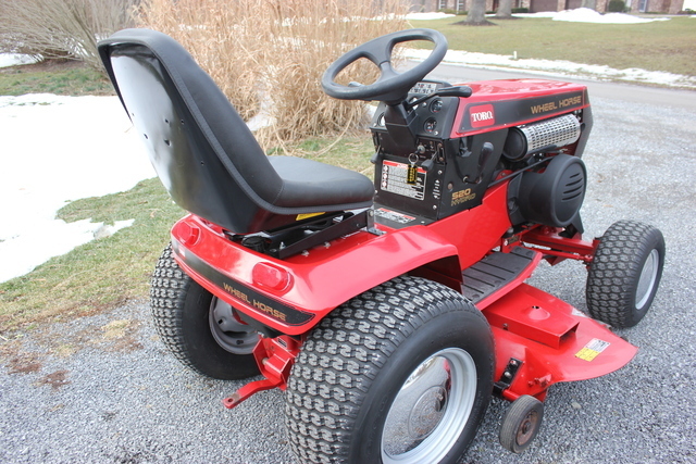

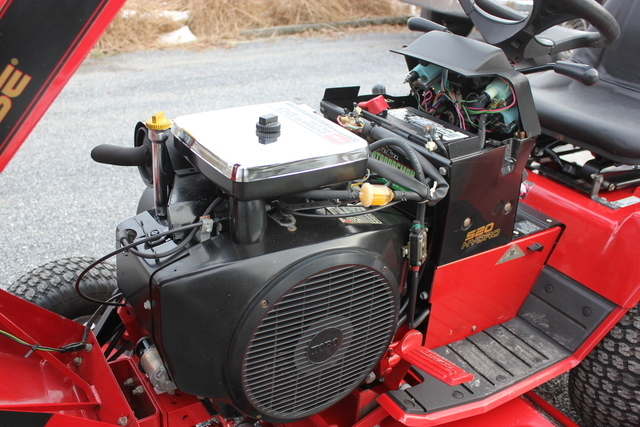

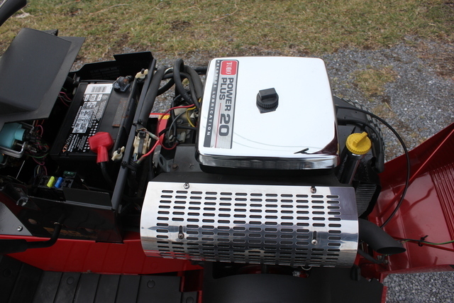

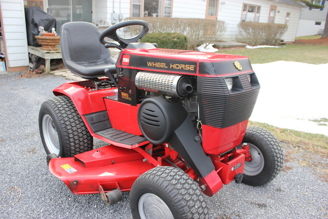

furykid 51 #1 Posted February 5, 2016 Besides the gold lettering , gold badge in front and the gray plastic hub cap which I don't have what else was special about Anniversary 520 H? What spark plugs do these P220Gs like the best? One other question for now, I'm sure I will have more... Is straight 30w engine oil the best for these? I will only be using her in the summer. The Hydro oil looks clean but I am going to change it and I will put 10w30 in it. Here is a few more pictures. 9 Share this post Link to post Share on other sites

cheesegrader 436 #8 Posted February 5, 2016 1996 50th anniversary 520's have the cosmetic badge changes that you mention, but no other changes that I can think of. There are a few subtle changes between the '93 and '94 (seat mounts, decals) There was also a carb change in the mid 90's to the crappy California emission carb. It is a pain to clean and rebuild, and if you get the chance, I would swap it for the older, adjustable version. I vent the belt guard over the rear cylinder on all my machnes, and replace the Phillips head screws on the dash and transmission covers with button head bolts before they strip. 1 Share this post Link to post Share on other sites

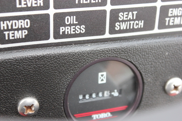

312Hydro 474 #14 Posted February 7, 2016 Beautiful tractor! I agree with hubcap decision as I like the chrome too. I think I'd feel better once I put an extra hour on that meter though! That's a really nice machine 3 Share this post Link to post Share on other sites

furykid 51 #18 Posted February 7, 2016 (edited) 1 hour ago, 312Hydro said: Beautiful tractor! I agree with hubcap decision as I like the chrome too. I think I'd feel better once I put an extra hour on that meter though! That's a really nice machine I plan on doing that tomorrow just to get off that number.... At 666 hours do you guys think that their is a need to decarbon the heads yet? Edited February 7, 2016 by furykid 1 Share this post Link to post Share on other sites
cheesegrader 436 #19 Posted February 7, 2016 I have to admit that I have not kept up with this schedule personally, shame on me. Decarbonization of the heads and valve adjsutment is recommended at 500 hours. Probably a good idea on a tractor where you don't have any idea of past care. (though it sure LOOKS good) 1 Share this post Link to post Share on other sites
furykid 51 #20 Posted February 7, 2016 9 hours ago, cheesegrader said: I have to admit that I have not kept up with this schedule personally, shame on me. Decarbonization of the heads and valve adjsutment is recommended at 500 hours. Probably a good idea on a tractor where you don't have any idea of past care. (though it sure LOOKS good) Sounds like the thing to do, I can clean everything while it's apart and adjust the valves. That way I can do it all at once and I will know it's been done. I will get the gaskets ordered and go to work on her. Share this post Link to post Share on other sites

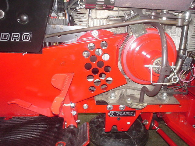

cleat 9,405 #23 Posted February 7, 2016 I have done this to all 3 of my 520's and also the 416 with the Onan engine. Should help. Cleat 3 Share this post Link to post Share on other sites
furykid 51 #24 Posted February 7, 2016 I like what you did to the belt guard. I was thinking either holes or slots. Is Boomer the one to go to for gasket kit to do the heads? Matts hydro pedal sure looks good on there also. Share this post Link to post Share on other sites
