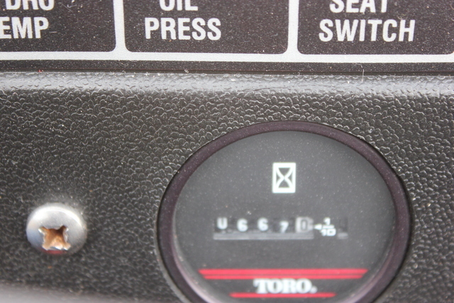

elcamino/wheelhorse 9,362 #29 Posted February 8, 2016 Ran it for an hour just to get the meter changed. 1 Share this post Link to post Share on other sites

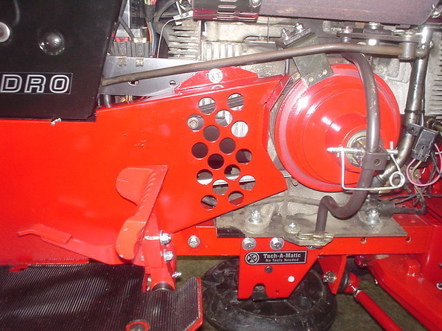

WHX?? 53,404 #31 Posted February 8, 2016 On 2/7/2016 at 0:20 PM, cleat said: I have done this to all 3 of my 520's and also the 416 with the Onan engine. Should help. Cleat Wait now till you get to 1313 hours!! How did you get those holes so evenly spaced Cleat?... Nice ...looks liker your machine are as clean as furykid's . Also nice to see your name in RED furykid! 1 Share this post Link to post Share on other sites
cleat 8,133 #32 Posted February 8, 2016 I drew it out on paper then center punched through the paper into the guard. Then drilled 5/16 holes and punched using a greenlee punch normally used by electricians for electric panels. Don't know if it helps but it can't hurt unless you stick your fingers through the holes. Cleat 2 Share this post Link to post Share on other sites
WHX?? 53,404 #33 Posted February 9, 2016 I got ya cleat, I have a greenlee punch... I believe it makes a 7/8" hole which I though might be too big?? Does make nice clean holes tho. I need to do this to mine but was thinkin cut out the whole area then somehow attach hardware cloth to the back side. Better yet take it to someone who has a plasma table and have it cut out like a then some cloth over it?!?!? Now that would be custom! 2 Share this post Link to post Share on other sites

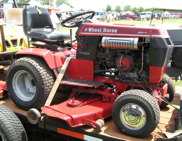

cleat 8,133 #34 Posted February 9, 2016 It would be ideal to have it louvered to match the top of the hood. Yea, my holes are quite big. Kind of negates it's function as a guard but really only the part back by your legs is the main hazard. Here is a picture I found on the internet with the whole front half of the guard cut off (and the chrome exhaust cover on upside down). Cleat 1 Share this post Link to post Share on other sites
cheesegrader 434 #35 Posted February 9, 2016 WHX6, The holes in my belt guard are 3/4. I haven't had issues with breaks in the area around the holes so far. Haven't put any fingers or toes through the holes, either! I think a punch would be faster, but I don't have one, so I went with a cheap step-cut drill bit from HFT Masked the area with tape, drew it all out the way I liked, and used a center-punch to dimple the start point for the drill. 2 Share this post Link to post Share on other sites
WHX?? 53,404 #36 Posted February 9, 2016 I was wondering how you did that too cheesy...they don't look like 3/4 from the pics ...I don't like the whole thing cut off cleat..just don't look right ...louvers are cool like the hood but gotta be $$ for some one to punch them. I plan on workin this girl like a $2 ho in the heat of the summer so this might keep me from poppin valve seats. Wouldn't worry about the big holes....shouldn't be sticking your you know what in ther anyway....thanks for the pics.. Have you got the 60" deck fury? 2 Share this post Link to post Share on other sites

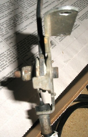

lynnmor 8,271 #43 Posted February 9, 2016 1 hour ago, roadapples said: Like to see a picture of that if you got time...thanks I believe that some new replacement throttles have solid rivets, so if you have one of those some drilling may be required. Here is a photo of a screw thru a hollow rivet: 3 Share this post Link to post Share on other sites
