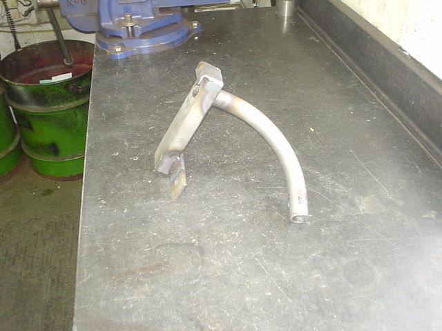

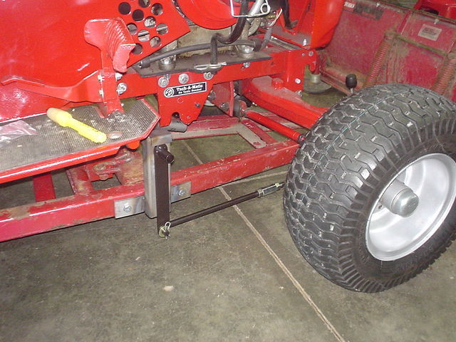

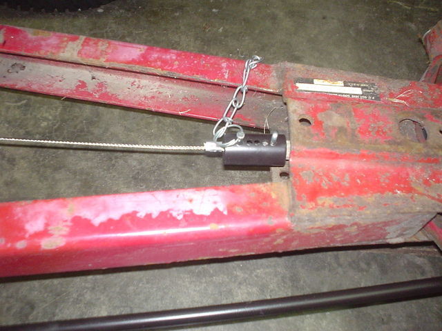

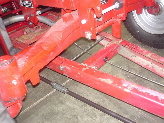

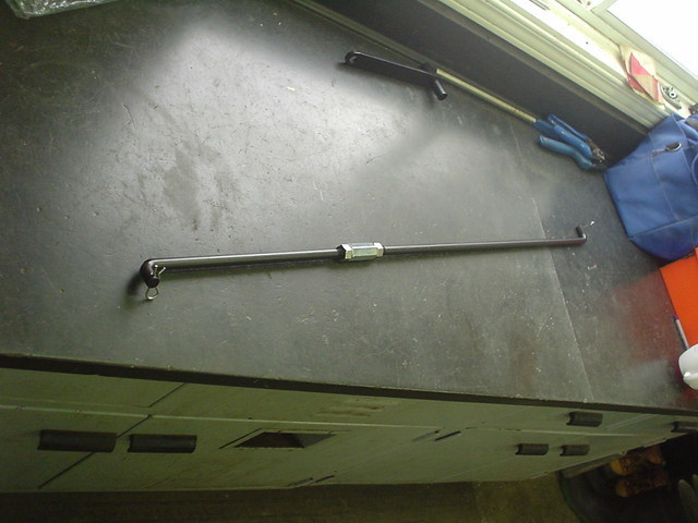

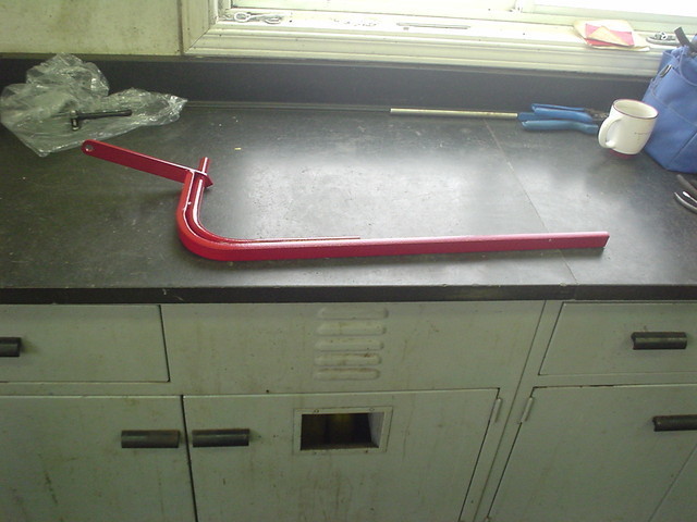

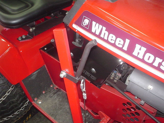

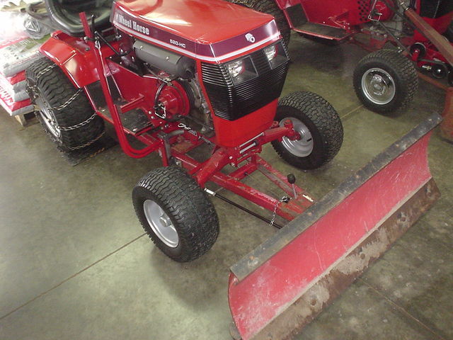

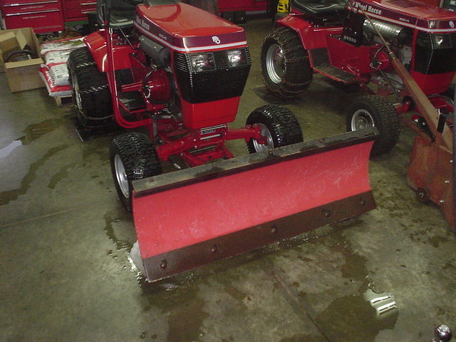

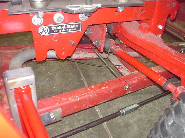

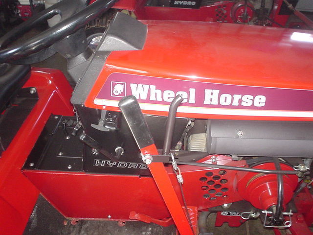

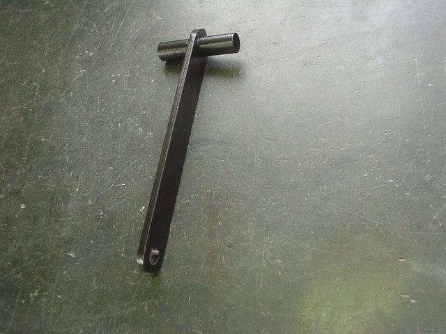

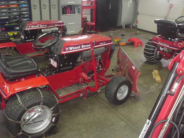

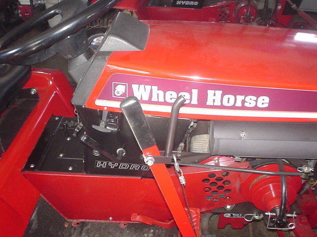

cleat 9,024 #26 Posted February 19, 2016 Blade is now fully functional. Bracket that holds handle to frame is complete except for paint Turn handle is complete. Turn rod is adjustable and complete. Handle installed and at various positions from left to right. Closeup of release lever and cable connections at blade. I also made up a little bracket to hold the turning rod when the handle is removed. Next will be to refurbish the blade itself but that will be a summertime job. 8 Share this post Link to post Share on other sites
Don1977 606 #27 Posted February 19, 2016 Looks great! Like the way you reinforced the handle. Share this post Link to post Share on other sites
cleat 9,024 #28 Posted February 19, 2016 I was afraid of the strength of the tube itself because it is fairly thin walled. Seems to work good. I may add one more cable guide to keep the cable further away from the steering components. Share this post Link to post Share on other sites
WNYPCRepair 1,924 #29 Posted February 19, 2016 Nice work, looks great! Share this post Link to post Share on other sites
cleat 9,024 #30 Posted February 20, 2016 (edited) I installed a rod to guide the cable down away from the steering as it could get caught at full lift and full turn. Edited February 20, 2016 by cleat 3 Share this post Link to post Share on other sites
can whlvr 994 #31 Posted February 21, 2016 nice fab work cleat,im surprised to put that rusty blade on that shiny 520 Share this post Link to post Share on other sites
cleat 9,024 #32 Posted February 21, 2016 Just wait until next year. Blade will match. I already have matt's decals ready to go on. I did not even try it on the last snowfall of approx 20" That made the big diesel work to clear that. Share this post Link to post Share on other sites

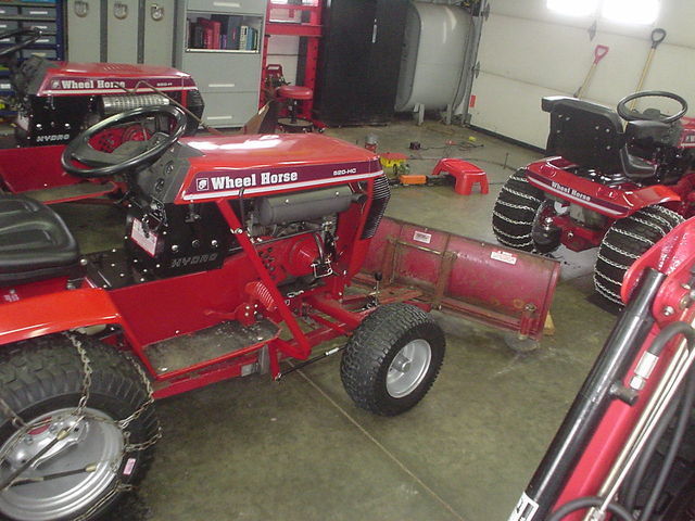

cleat 9,024 #33 Posted February 22, 2016 Installed a good used mower deck height grip onto turn handle. Looks better and is easier on the hand. 2 Share this post Link to post Share on other sites

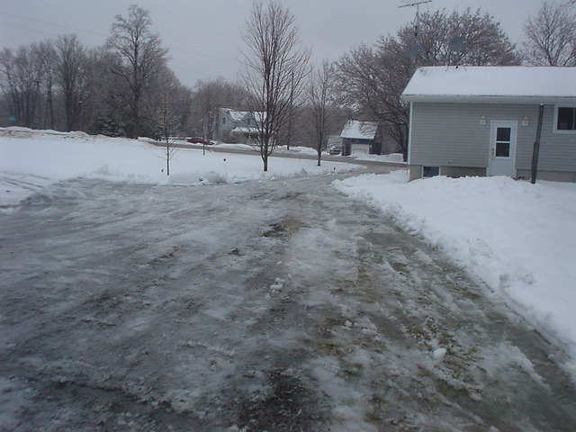

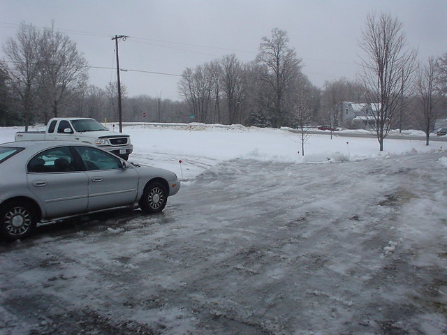

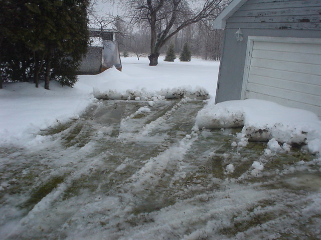

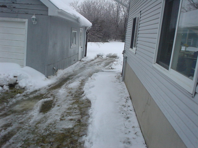

cleat 9,024 #34 Posted February 25, 2016 (edited) I got to try out the blade yesterday since we got a wet snow/rain mix. No blower would like this, it was about half water and half slush. Even with the blade at full rotation, it would push a lot of snow ahead as it was so packy. 520-HC performed well however, not losing traction once even pushing this heavy wet slop with ice underneath. It even has the 4 link chains on it. Next year it will have a good set of chains. I think I will add the front stabilizer as Toro did to stop the sway of the blade under load. That must put a lot of stress on the rear axle and the axle mount. 3322-786 5xi dozer stabilizer instal instr.pdf Edited February 25, 2016 by cleat 2 Share this post Link to post Share on other sites
cleat 9,024 #35 Posted February 28, 2016 I got to try out the blade yesterday since we got a wet snow/rain mix. No blower would like this, it was about half water and half slush. Even with the blade at full rotation, it would push a lot of snow ahead as it was so packy. 520-HC performed well however, not losing traction once even pushing this heavy wet slop with ice underneath. It even has the 4 link chains on it. Next year it will have a good set of chains. You will notice the turn handle tilts in a bit at the top. I bent the tubing and the handle past 90 degrees to achieve this. Makes the handle easier to grab and use. Here are all the plans hand drawn in case anyone wants to make their own. Snow blade turn handle overview.pdf I have started making the front stabilizer and have started a new topic for this here 2 Share this post Link to post Share on other sites
