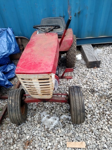

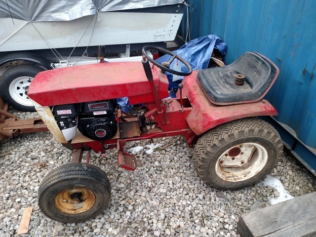

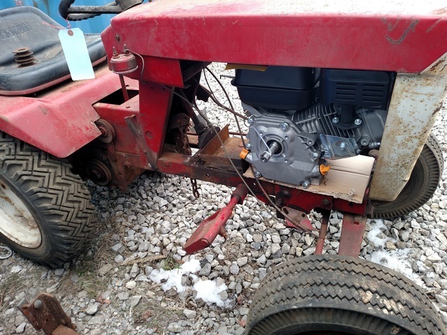

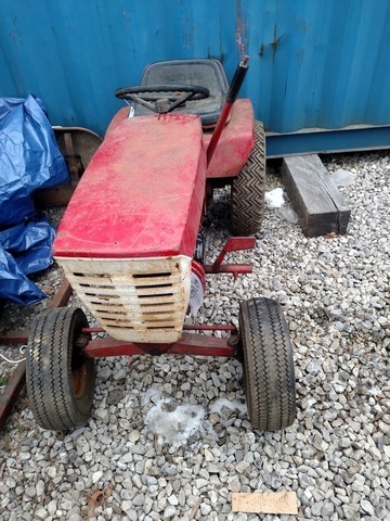

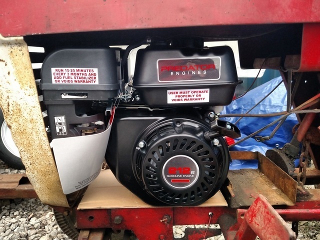

luke000 44 #1 Posted January 27, 2016 As some of you may know from my introduction post I picked up a 1965 model 655 (serial number of 107102) at an estate auction with a blown out motor, plow, and mower deck for a whopping $5.95 after tax. Overall the tractor is in good shape, the front tires are shot, the belt cover has some rot, and the rear fender has some dents. Besides that it will need a few small odds and ends and some new paint, but nothing I cant handle. I purchased a new 301cc Predator 8HP from HF the other day with hopes that it would fit without any issues but the motor was just too big for the tractor without doing some major body work to the hood/frame. I went back and exchanged it for the 212cc 6.5HP version and it fits very nice with only minimal work to get it installed (and my bank account liked it too, cost %44 of what the 8HP did). Next step for me is to take care of the body work and take care of any mechanical issues. I have some new front tires, decals, choke/throttle cables on order right now as well. Im not sure how fast I will be moving on this project, I am in my senior year of school and have 2 other projects going at the same time, plus its winter here in Mi. One quick question for today, what is a good paint to use for these tractors? I don't necessarily want to just do a rustoleum spray-bomb job, I want it to look good and last a while. I do have some spray equipment but I am not opposed to rattle cans either as long as it is a good quality paint (on a budget <$50/gal) 4 Share this post Link to post Share on other sites

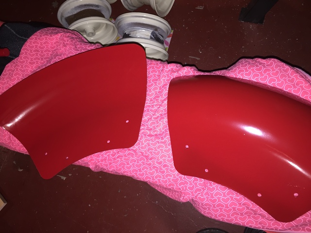

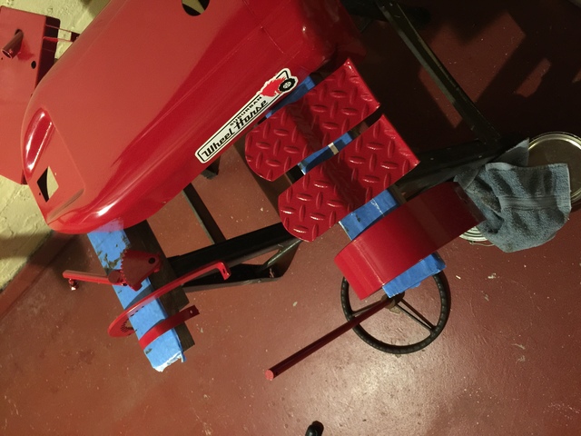

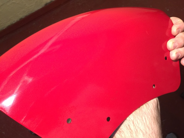

luke000 44 #4 Posted September 28, 2016 Hello everyone, I'm back! It has been a busy few months for me, I got my other two big restoration projects finished over the summer and so I finally was able to turn my attention back to the 655. I have spent a few days the three weeks working on it, I got the body stripped down, straightened out (best I could), primed and painted. I used Majic IH Red paint with hardener and sprayed it with my HVLP gun. It came out pretty good with only a few spots here and there that only I will see. I was able to change the front tires and tubes, it was much harder than I was expecting to do. Ended up taking it to a friends shop to use their tire changing machine. The steering wheel was very dirty with years of built up grime, I was able to clean it with slightly abrasive cleaner wax for boats. The wheels I painted with leftover paint from one of my other projects, but the front wheels defiantly need to be touched up after changing the tires. That is about where I am at now in the project, not much left to do besides install the engine controls, and a few small parts. 9 Share this post Link to post Share on other sites

luke000 44 #7 Posted October 5, 2016 I spent the last day and a half getting the 655 much closer to completion! I was able to get a plate made and painted to adapt the new motors bolt pattern, got the motor installed, throttle cable installed, I tightened up the steering by replacing a bolt the PO had put in there with a proper roll pin, changed the uni-drive oil, made a temporary belt, and got a seat put on. Sure enough I put some gas and oil in the engine and she runs good! It is a lot of fun to finally drive it, I spent about an hour doing that today around the yard. My list of things I still need to do before I a truly done: - Proper belt - Re-work belt cover to fit the new egine - Paint the snow plow and mower deck - Repaint the hood - Repaint the front rims - Get a set of proper decals - Touch up misc paint 11 Share this post Link to post Share on other sites

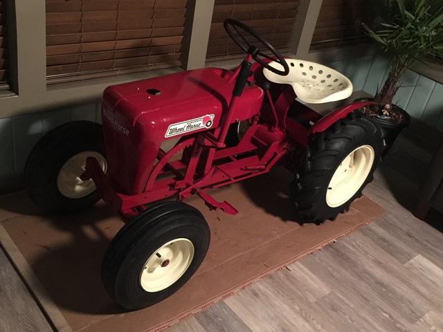

luke000 44 #19 Posted October 29, 2016 As of today, the 655 is finished! I am very happy with how it tuned out, it runs great and the snow is just around the corner to really try it out. The mower deck still needs some work, but that will get done some time this winter. Decals tuned out great and really put the finishing touches on the tractor. I am glad I repainted the hood and belt cover, the finish improved a lot. 7 Share this post Link to post Share on other sites
