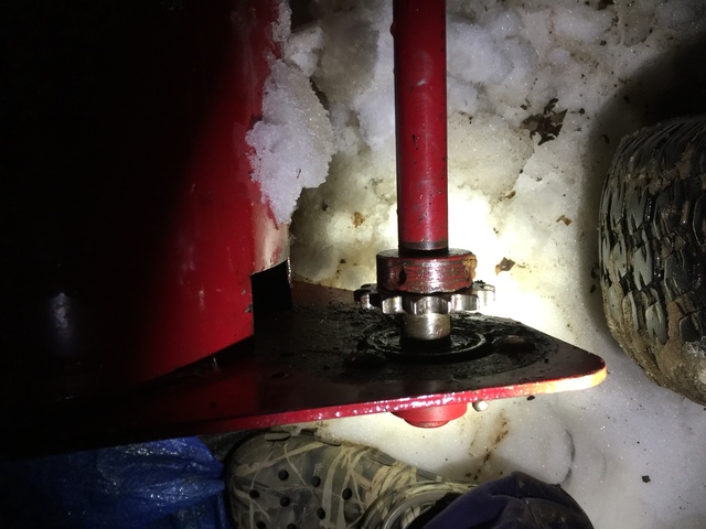

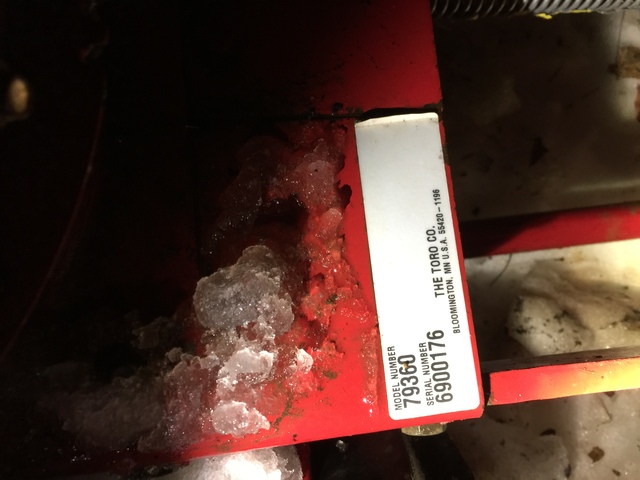

Akestner 36 #1 Posted January 27, 2016 Hey everyone help would be greatly appreciated tonight while using my single stage tall Shute blower I had one the sprocket come loose and the blower ate the chain I got the chain out but I need a new be it twisted it to bad to use so I need to know the chain size I also need to know the chain route the other problem I have is what to do about the sprocket on the outer part of the blower where exactly it goes and how do I reattach it here are some photos to help model number and the sprocket Share this post Link to post Share on other sites
gwest_ca-(File Mod) 11,472 #2 Posted January 27, 2016 Here are the manuals Is the sprocket that came off one of the two idlers located out front above and below the auger sprocket? Chain routing in this topic Garry Share this post Link to post Share on other sites
doc724 925 #3 Posted January 27, 2016 Chain is a number 40. Don't forget quick links and a chain breaker tool (although a punch may do it in a pinch) Share this post Link to post Share on other sites
jeff lary 173 #4 Posted January 28, 2016 Like your Crocks I have 2 pair just like em, good luck on your chain replacement. Share this post Link to post Share on other sites
Akestner 36 #5 Posted January 28, 2016 Thanks everyone for the help I got it fixed and running again, thanks I actually have 2 pairs of them as well Share this post Link to post Share on other sites
