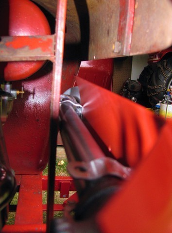

clueless 3,348 #1 Posted January 26, 2016 Anybody got a good source for the clips that hold the exhaust guard on the 3/4in pipe? Bought a set a HD, didn’t hold worth a damn, bought another set at Ace, same thing. Originals fit pipe much better. If not anybody got any original ones for sale? Chris in Florida Share this post Link to post Share on other sites
Jake Kuhn 1,598 #2 Posted January 26, 2016 Chris, All the clips I have found usually have that problem. I usually bend them a little bit to make them fit the pipe better and they hold pretty good. But have to be careful because they can break easy when you pry on them to bend them. 1 Share this post Link to post Share on other sites
857 horse 2,588 #3 Posted January 26, 2016 cluless....i think i found a fix......will post pics tomorrow common item in H depot or Lowes.....But im not worth a damn describing what its called.... 5 hours ago, clueless said: Anybody got a good source for the clips that hold the exhaust guard on the 3/4in pipe? Bought a set a HD, didn’t hold worth a damn, bought another set at Ace, same thing. Originals fit pipe much better. If not anybody got any original ones for sale? Chris in Florida Share this post Link to post Share on other sites
wallfish 19,345 #4 Posted January 26, 2016 Broom handle clips. These are from Ace but not sure why they wouldn't hold http://www.acehardware.com/product/index.jsp?productId=1291997 Share this post Link to post Share on other sites
AMC RULES 37,254 #5 Posted January 27, 2016 The only ones I've found that absolutely stay put... are a little heavier guage, and have a nut and bolt running through the back of 'em. 4 Share this post Link to post Share on other sites
wallfish 19,345 #6 Posted January 27, 2016 (edited) those look like 1/2" EMT (electrical conduit) stand off clamps Get the 3/4 and you can put a bolt through the 2 holes and they won't go anywhere Edited January 27, 2016 by wallfish 1 Share this post Link to post Share on other sites
AMC RULES 37,254 #7 Posted January 27, 2016 (edited) They are John. I found the 3/4" needs the bolt (PITA)to lock the shield in place, but with a slight tweak the 1/2's...you don't. Edited January 27, 2016 by AMC RULES Share this post Link to post Share on other sites
JPWH 6,542 #8 Posted January 27, 2016 (edited) B- line makes those in a spring steel. Don't know if that would work or not just thought I would mention it. Edited January 27, 2016 by Hank01 Share this post Link to post Share on other sites
WHX?? 55,145 #9 Posted January 27, 2016 Good idea...we call them mineralac clamps, best part is I buy them by the box in all sizes for work. Hmm wonder if I can get them in stainless??? 1 Share this post Link to post Share on other sites
