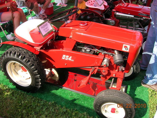

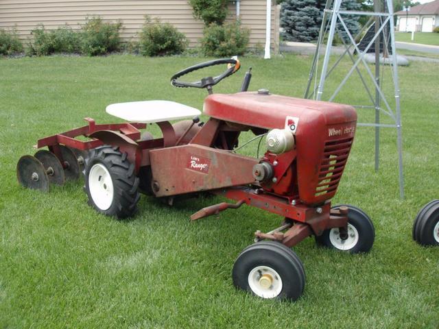

Here is what you need and what the early lawn ranger is.  The engine tab is the difference.   The tab can easily be replaced if you weld or can have someone else weld a different one on.
I'd find a shield with the indent for the model decal as the 854 originally had this and it matches the indents for the hood decals.  A nice touch IMO.

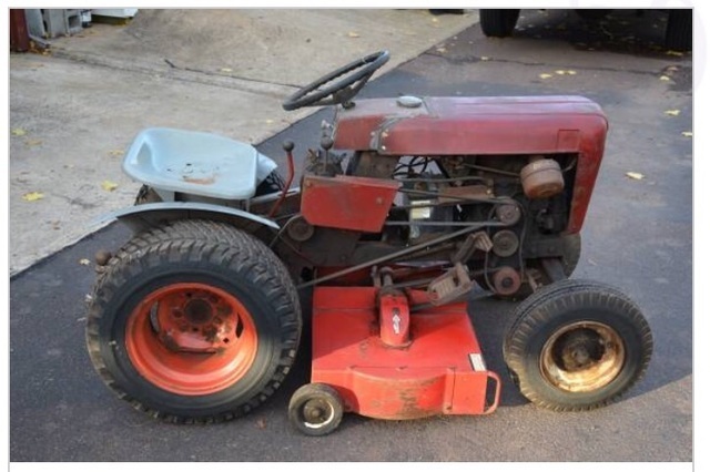

DeHart16
Picked up my tractor yesterday...this is what I am working with. Engine is strong with tons of compression. I need a battery so looking for suggestions on that...total sand and repaint of all metal is that plan.
