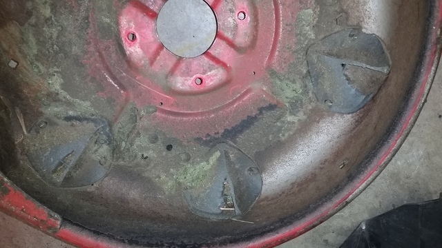

WHX?? 58,307 #1 Posted January 25, 2016 Deck on the wife's 16-38 was making a starting to make a littel noise last fall so decided now was a good time for new bearings. These plastic pieces are monted on the bottom side and are called kick plates in the ipl. There are five of them. Can anybody tell me what their purpose is? They are pretty chewed up as you can see and was wondering if they should be replaced. This is suposed to be a "recyler" or mulching deck but I have never used it that way. Share this post Link to post Share on other sites
WH nut 553 #2 Posted January 25, 2016 They are there to force the clipping back down into the blade to be chopped again Share this post Link to post Share on other sites
WHX?? 58,307 #3 Posted January 25, 2016 Thanks nut... a function of the mulching deck then? maybe I should just take them out? This girl has a bagger on it most of the time. Share this post Link to post Share on other sites
