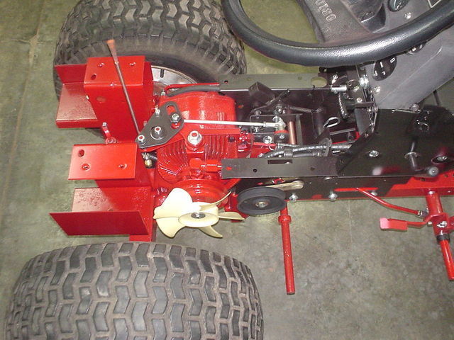

cleat 8,101 #8 Posted January 25, 2016 (edited) Actually, the 500 series cover plates come off with little to no wiring attached (early models have parking brake and motion safety switches on the bottom of the lower cover). Other than that, pull 8 little screws and remove both plates and the entire lift mechanism is very much exposed. You can then easily figure out what to do. Just do not tighten the lift chain so much the lift bar hits the steering gear and bends something (been there adjusting it to try and lift the 60" deck higher). This pic shows a bit more room with the rear fender off but you get the idea. Cleat Edited January 25, 2016 by cleat 2 Share this post Link to post Share on other sites

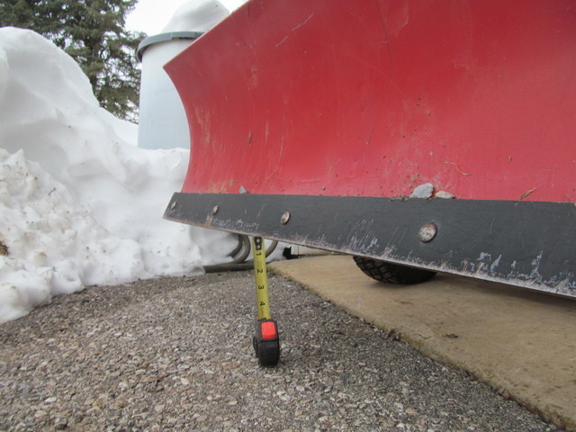

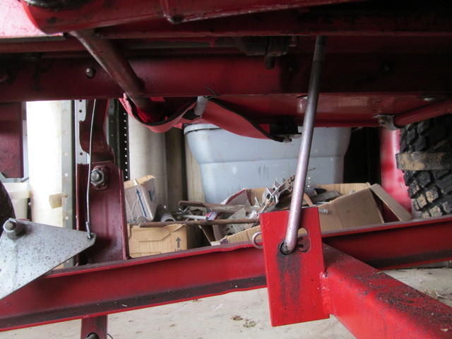

Ed Kennell 43,802 #18 Posted January 27, 2016 OK, ts. here are a couple pics of my 312 Hydro plow tractor. You can see I don't use the deck lift item 27, and I have the solid link so I can apply down pressure. The plow lifts 6-7" before it hits the frame and it will go 1" below level with down pressure. You should get a little more height before hitting the axle on a 520 with the bigger front tires. I can reach and remove the top of the link although I agree it would be more difficult with the 27 lever in the way. 4 Share this post Link to post Share on other sites

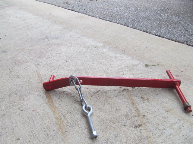

Tankman 3,525 #21 Posted January 28, 2016 (edited) On 1/27/2016 at 6:25 PM, tsmall07 said: Looks like I need to build a solid link... I've made a few solid links. 5" x 1-1/2" x 1/4" steel flat bar. Two 3/8" clearance holes 4" OC (on center). Pick up (2) 3/8" clevis pins, hair pin cotter pins, flat washers. Stock at Home "Cheapo" and Lowes. Done. The short link, I've made in various lengths; i.e.: image attached. Edited February 4, 2016 by Tankman 1 Share this post Link to post Share on other sites
