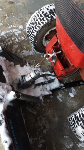

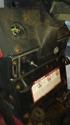

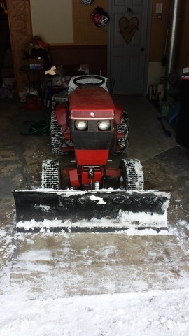

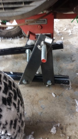

OldRedWheelHorse 7 #1 Posted January 24, 2016 Hello All, First post to the forum. Great forum! Though this might interest/help out someone else: I got a atv plow for free and was able to fit it to my 516-H as a quick attachment. I cut off the existing bracket on the plow and cut a few pieces of flat steel and fitted a rod on the top that will connect to the quick attach where the deck hangs. I wired a 3-way momentary switch to the plow, put some rubber chains on and I was in business. Still need some work to finish it up (Grind off all sharp edges and some black paint), but was in a rush to get it finished before the big storm. Handled a foot of snow pretty well! Here are some pics: 6 Share this post Link to post Share on other sites
russellmc301 601 #3 Posted January 24, 2016 nice just i would bottom out with the plow so low to the ground. Share this post Link to post Share on other sites
roadapples 6,985 #4 Posted January 24, 2016 That won`t be as hard on the frame were the transmission mounts. And welcome to Red Square.... Share this post Link to post Share on other sites

mmmmmdonuts 274 #9 Posted January 25, 2016 Awesome setup. I got an ATV plow at home collecting dust and this would be a nice project to do. Is that some sort of bottle neck pump to move the plow up and down? Does it tilt sideways? Share this post Link to post Share on other sites
OldRedWheelHorse 7 #10 Posted January 26, 2016 4 hours ago, mmmmmdonuts said: Awesome setup. I got an ATV plow at home collecting dust and this would be a nice project to do. Is that some sort of bottle neck pump to move the plow up and down? Does it tilt sideways? Thanks. The plow has a small winch that hooks to a bracket with an eye hook on the front of the tractor that lifts it. It angles left and right with a pin. If yours doesn't have a winch you could get an inexpensive one and mount it where I have the eye hook. Doesn't take much of a which to lift an atv plow. Put some pics up when you get it together, I'd love to see it. Good luck! 1 Share this post Link to post Share on other sites
