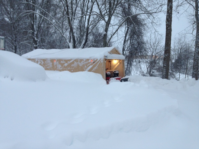

Eric C 109 #41 Posted January 24, 2016 This is what I'm dealing with now. 20 plus inches. I usually plow 6 to 10 inches at a time. But the bulk of this dumped on us Friday night into Saturday. My only shortcoming with this storm was a lack of weight. I have all four tires filled plus 110 lbs of weight. In the last 2 pics, there is nowhere to push the snow except foward due to the way my driveway is cut into the hill. I had my son (he is about 180 lbs) stand on the sleeve hitch and my 520 pushed like a freight train! My son and wife could hardly believe the snow we were pushing. 9 Share this post Link to post Share on other sites
