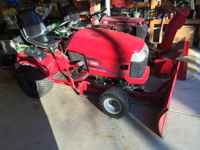

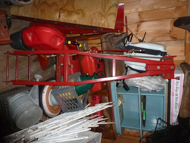

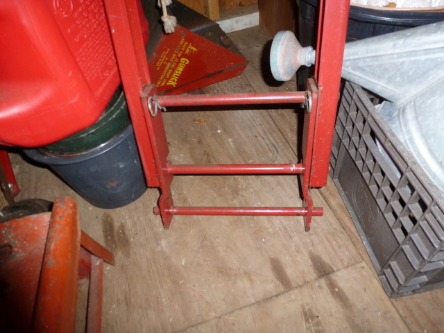

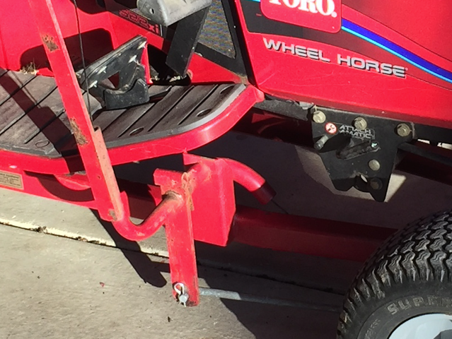

420lse 18 #7 Posted January 24, 2016 Here are some pics but the 520h plow looks basically like most plows that fit C thru 400 series except for the extension and the curved adjustment arm. 1 Share this post Link to post Share on other sites
DennisThornton 4,773 #8 Posted January 25, 2016 I was thinking the extension might be needed but I didn't know the adjustment assy was SO much different. But, some time, a few pieces, some heat, vise and maybe a torch.... 1 Share this post Link to post Share on other sites
420lse 18 #10 Posted January 27, 2016 (edited) Thanks to everyone for your answers and pics. Looks like a no go unless serious mods are undertaken. Not to mention converting a perfectly good plow into a frankinplow. Thanks again Moe Edited January 27, 2016 by 420lse Share this post Link to post Share on other sites
